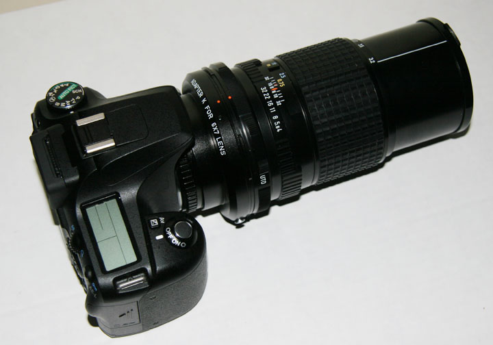

Could you post some pictures of the DSLR with a 6x7 lens mounted. Those lenses are huge and cost more than the DSLR when they were new.
This is with a 67 Macro 135mm, it's the only one I have on me. I have a 67 300mm that would swallow that camera body whole, it's huge. I have close to 10K invested in 67 lens/body, I'm so glad to be able to use them on a digital body now.
BTW, thanks guys.
