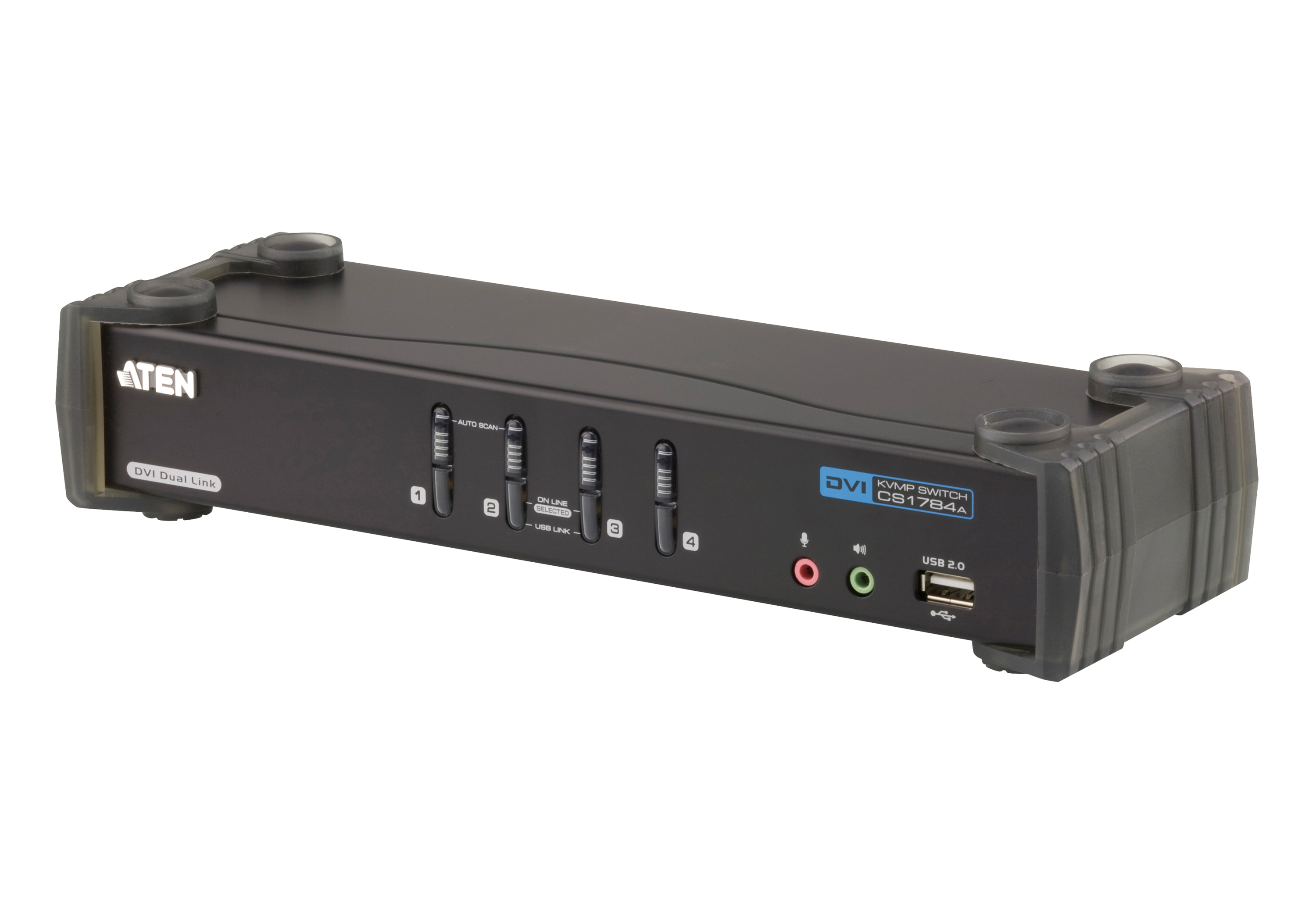

I did do a quick search on Amazon.
It looks like you can get dual link dvi kvm's, but they are about £300-£400.
may be worth a better search....;)
It's if they can do 30" resolution is the question..
Reactions: weezin
MarkC426
macrumors 68040
May 14, 2008
3,628
2,055
UK
This one supports 2560x1600 £245 Amazon
Read the Amazon reviews
See spec on Aten site
Reactions: weezin

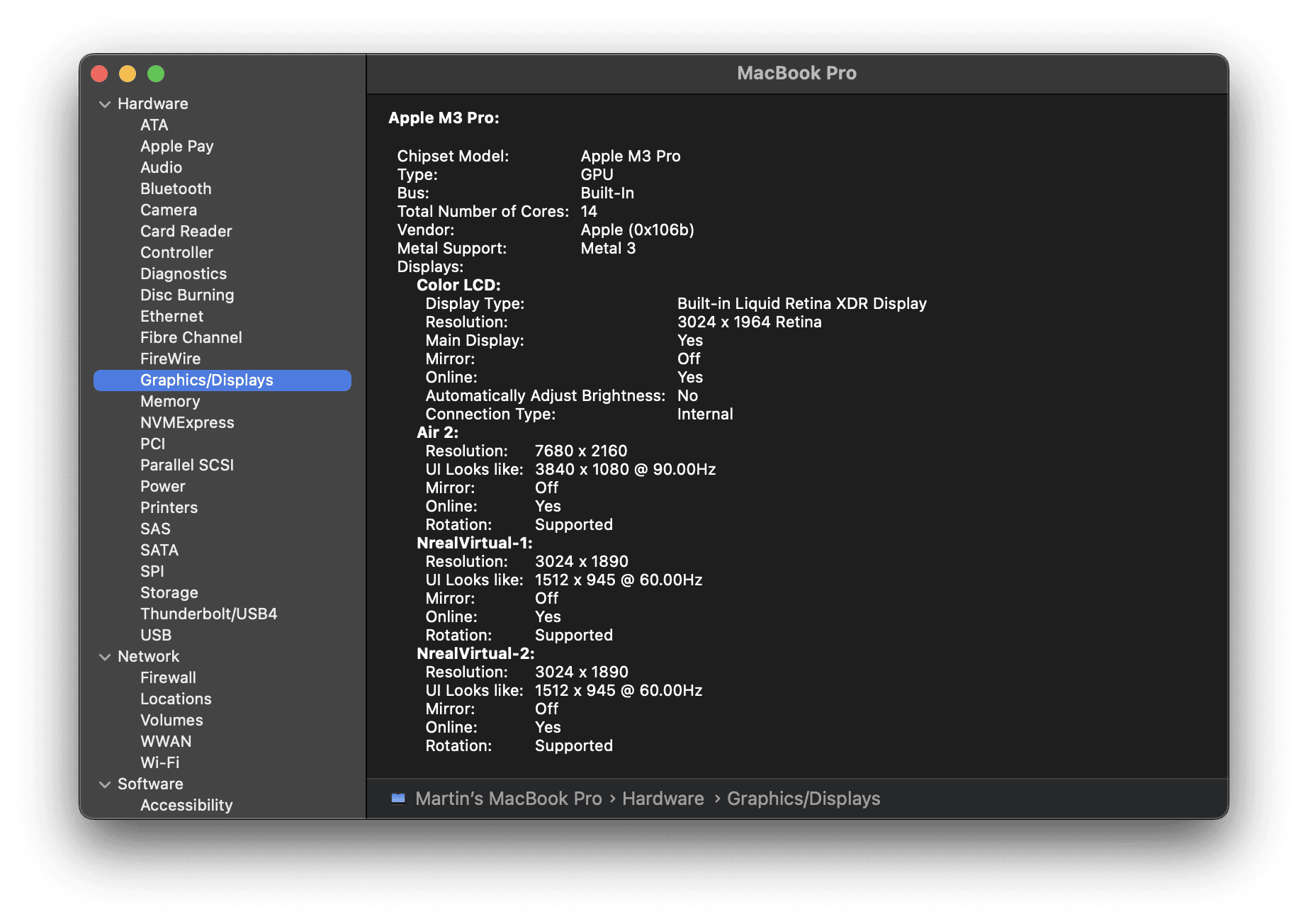

Anyway, for lacking of space, my own solution is to use the AR glass virtual monitor. It's not perfect, the FOV is limited, but it's good enough for my normal usage. And it can give me up to 3 virtual monitors inside the AR glass.
And the setup cost is low, just around ~$350. Of course, the power usage is very low as well.
