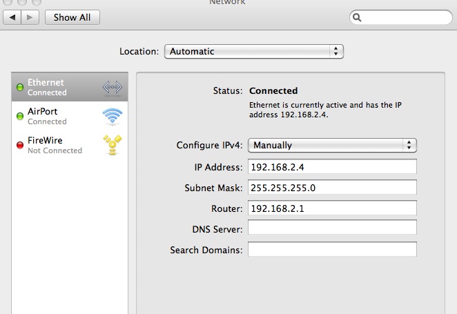

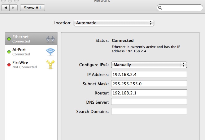

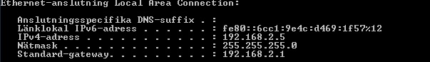

Hi, I'm trying to share my wireless internet connection from my mac to my PC, the mac is connected to a switch with a tp cable and my windows pc as well.
The switch doesn't have dhcp so I had to manually type in the ip address:
Mac:
192.168.2.4
255.255.255.0
Gateway: 192.168.2.2
PC
192.168.2.5
255.255.255.0
File sharing works between the two so I guess the connection is working 😛

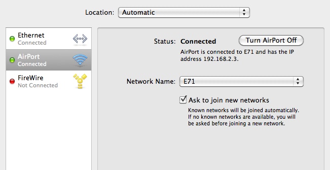

The airport on the mac is connected to a wifi network: ip adress: 192.168.2.3.
Now, sharing between the pc and mac is working through the switch, and I got a wireless internet connection on the mac.
In sharing(on the mac) I checked "internet sharing" and shared from airport to computers that uses Ethernet.
But... internet is not working on the pc... 🙁 Can anyone help?

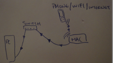

😛 The wifi comes from a phone with wifi sharing :

Why? I think the only interesting here is that I want to share the macbook's wireless internet, where it comes from isnt really a problem ? Or do you mean a bridge between the pc and macbook? why is there a setting in internet share if this is needed?
What r0k means is that you want the Mac to act as an Ethernet Bridge - in that it "bridges" the Wireless and Wired connections to act as 1 connection (ie the Mac passes all the internet packets to and from the Cell Phone to the internet)
So, the pc doesn't have a wireless card and the mac obviously does and you want to hook the ethernet ports of the two systems together and share the connection on the mac to the pc.
The thing that could be messing with people's minds is that the wireless access point probably runs off ethernet, right? Does the access point have another ethernet port that you could run the pc from. It's harder to share a wireless connection than a wired connection and receivers generally aren't good at broadcasting, meaning the mac.
A bridge does just like a bridge in real life does: It takes a network and 'bridges' it across some distance so that it can be used to support many computers again and helps manage traffic. Think of it as an extention or extender. Bridges aren't to expensive either but then neither is a simple USB wifi plugin for the pc. If it's in range. Problem solved. Network bridging

I tried what you said, and the windows did get an ip from the mac. And network between the mac and pc is working, but the internet on the pc still doesn't :/ I don't understand, why is there an option for internet sharing if is doesn't work?

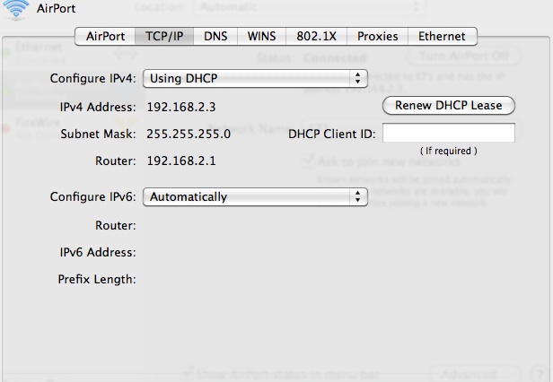

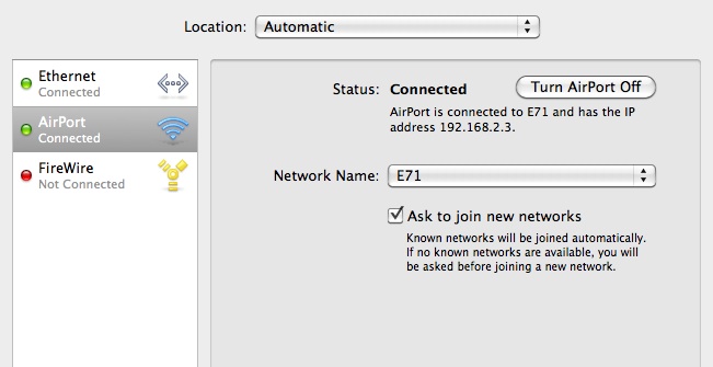

Here is all my settings:
And the internet sharing settings is of course active.

On the pc, run cmd and type
ping yahoo.com
You will probably get a dns error and may also get a destination unreachable error.
If you don't get a dns error, that means your pc went to your mac and asked for the ip address of yahoo.com and your mac in turn asked your phone which in turn asked a nearby nameserver and returned the response. This would be a very good sign.

Right, first I'd have a different subnet for your share since the Mac is effectively connected to two networks.
You've already set internet sharing on airport so that's good.
Configure the mac and the PC on a different subnet, say 192.168.3.0/24 for the sake of argument.
Mac ethernet.
IP:192.168.3.1
Mask:255.255.255.0
Router:192.168.3.1
DNS:Blank
PC Ethernet
IP: 192.168.3.2
Mask: 255.255.255.0
Gateway: 192.168.3.1
DNS: 8.8.8.8, 8.8.4.4 (or the IP address of your router)
Denarius,
I've been looking all over for this solution. Seriously looked through 28 pages on google, and this completely did the trick!
I understood the problem was that my airport and ethernet were using the same subnet, but I didn't know the IP's to put in.
Thank you SO much!
