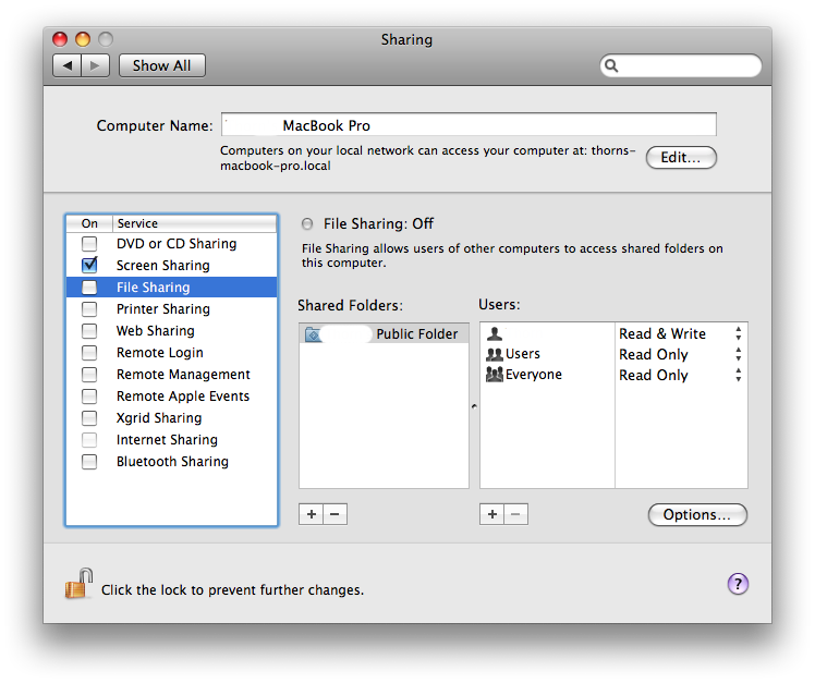

You can simply click + in the Sharing System Preferences and specifically add the other folders you want them to be able to access. 🙂
It's even easier in 10.5.3 - just select "get info" on a folder, and there's a new checkbox called "Shared Folder". Set this check box and the folder is available on the network!
