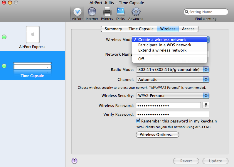

Hmm... I was under the impression that the AEBS could do that.. (I have a TC but same wireless setup).... but perhaps this doesn't create a second wireless network, only extends the "range" of the first?
