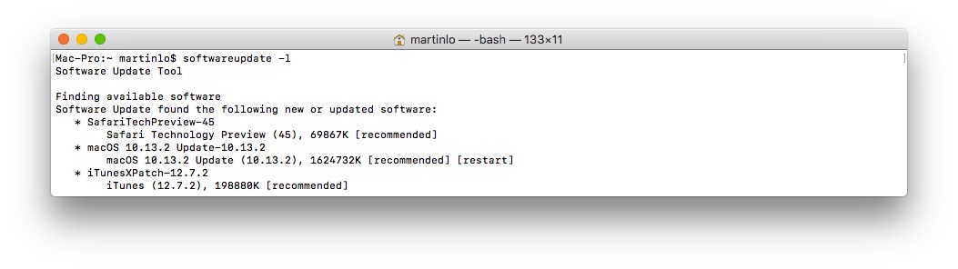

1.1 - optional) Open Terminal and enter "softwareupdate -l" to confirm the OS update is there.

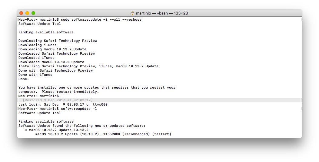

2) In Terminal, enter "sudo softwareupdate -i --all --verbose". Then you can see the update progress. Wait until it finish and ask you to restart (DO NOT RESTART). For info, if you enter "softwareupdate -l" again, you may see the update still there (with different size), but doesn't really matter.

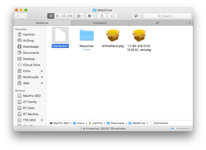

3) still in terminal, enter "pkgutil --expand ~/Downloads/WebDriver-378.10.10.10.25.102.pkg ~/Downloads/WebDriver" (This is base on step 1's assumption. Please replace the files name or location accordingly)

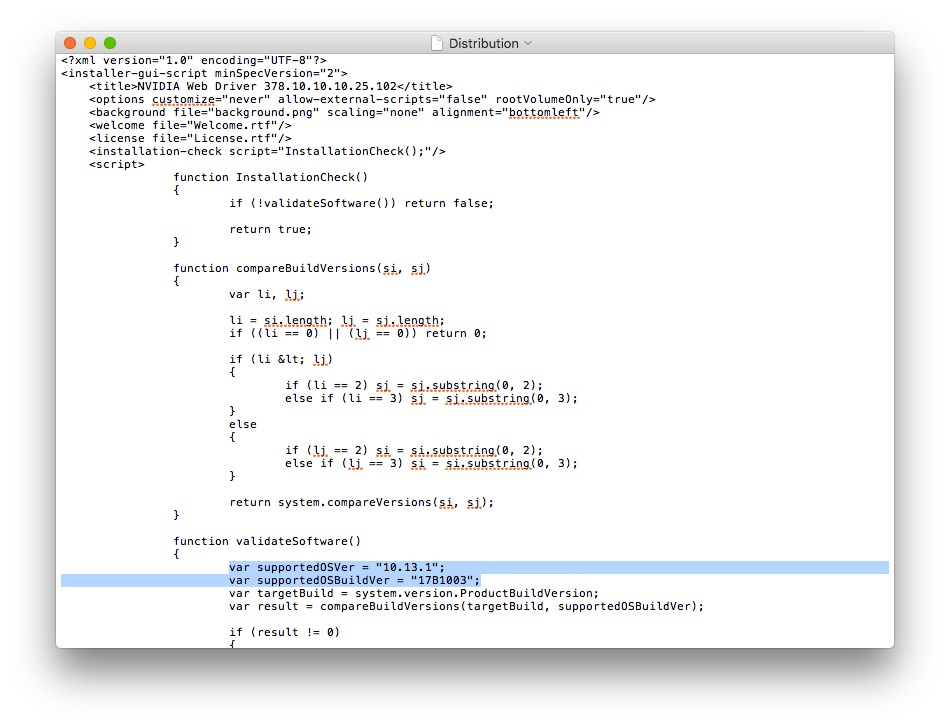

4) Go to your user profile's Downloads -> WebDriver folder, and use TextEdit to open the file "Distribution"

6) In TextEdit, go down to supportedOSVer, and change BOTH the OS version and build number as per the info you get from step 5. Then save it.

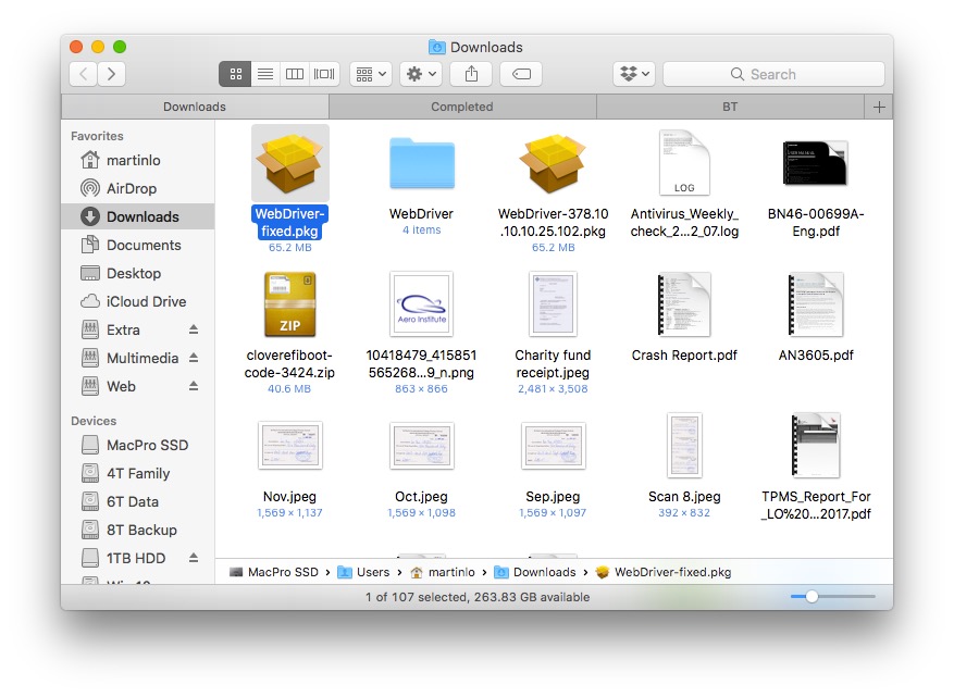

7) In terminal, enter "pkgutil --flatten ~/Downloads/WebDriver ~/Downloads/WebDriver-fixed.pkg". Now, you have a working installer called "WebDriver-fixed.pkg"

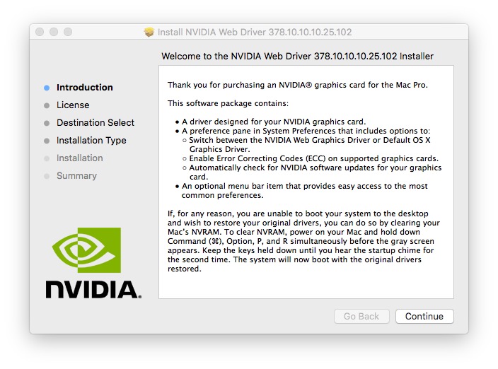

8) Run this fixed installer, at the end, it will ask you to restart, DO NOT RESTART.

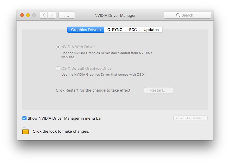

9) Back to terminal and enter "sudo nvram nvda_drv=1"
10) Open Nvidia web driver preference pane (you may see two manager icons on the menu bar, that's normal), and confirm Nvidia web driver is selected.

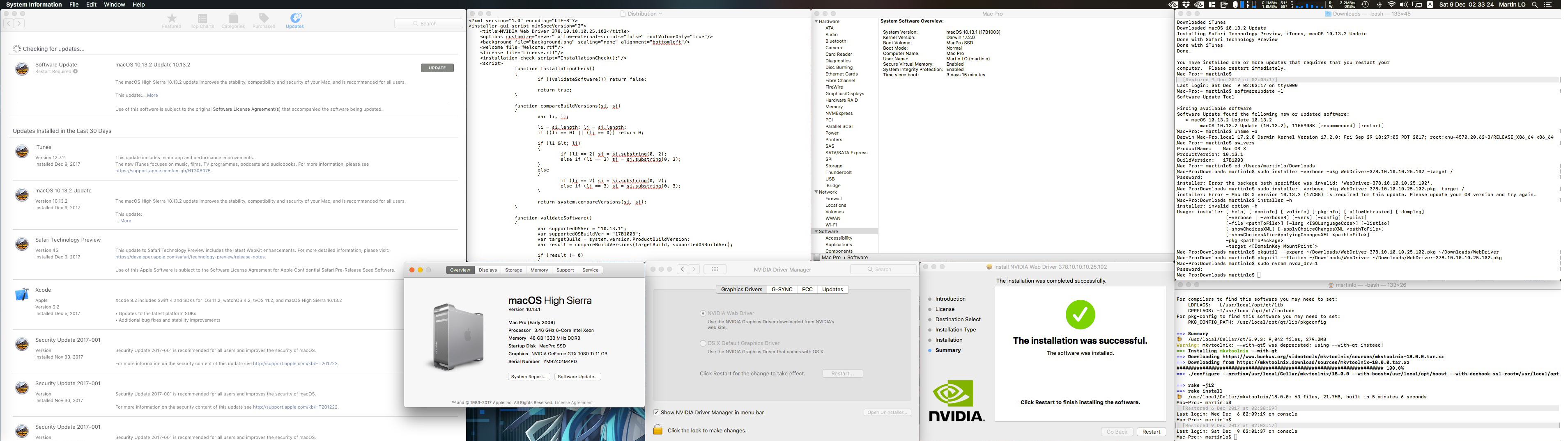

The following screen capture pretty much summarise all the steps above. As you can see, there are 2 Nvidia web driver manager on the menu bar. One icon belongs to the old driver, which is disabled already. If you click it, you will see "OS X Default Graphics Driver" selected. And another one is the new one, if you click it after step 9, you should see "NVIDIA Web Driver" is selected.

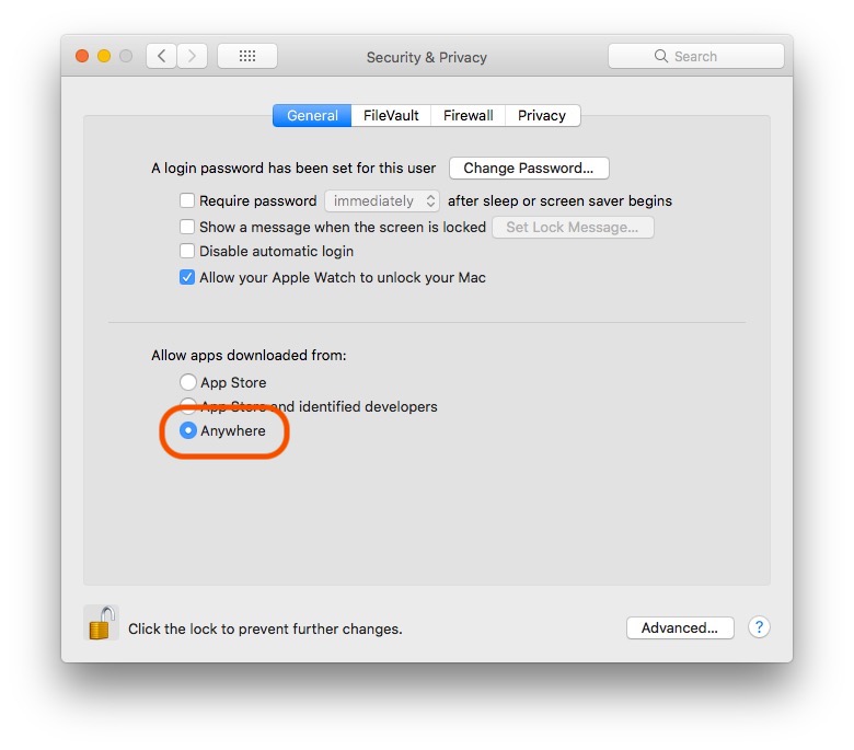

[doublepost=1512946771][/doublepost]To disable Gatekeeper
1) Open terminal
2) Enter
Code:
sudo spctl --master-disable
3) Open System Preferences -> Security & Privacy, and Choose "Anywhere"

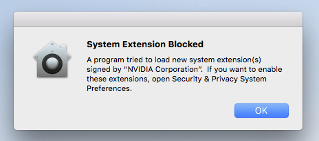

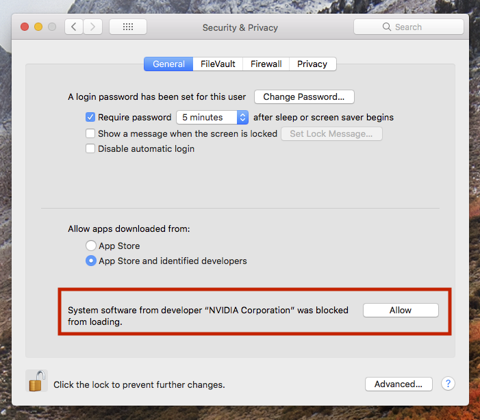

The problem is not to run the installer, but will GateKeeper block the driver loading on next reboot.
I didn’t use GateKeeper, but AFAIK, after Nvidia Web Driver installed, you can go to the same Security & Privacy page to "Allow" it (A notice should be there, but since I never use it, so not 100% sure. Both SIP and Gatekeeper OFF works so well with me, I just have no intention to re-enable them again).
Gatekeeper doesn’t block drivers, having it on or off shouldn’t matter.
