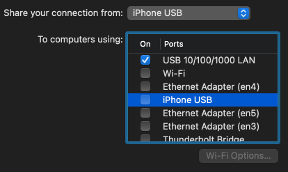

I have a USB Dock with 2 USB C Ports that provides and ethernet connection. See the attached image for my current internet sharing settings (not turned on)
