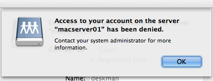

Any idea why i'm getting the attached error message when going to finder, connect to server, smb://macserver01/Templates get asked for credentials then that comes up after entering them.

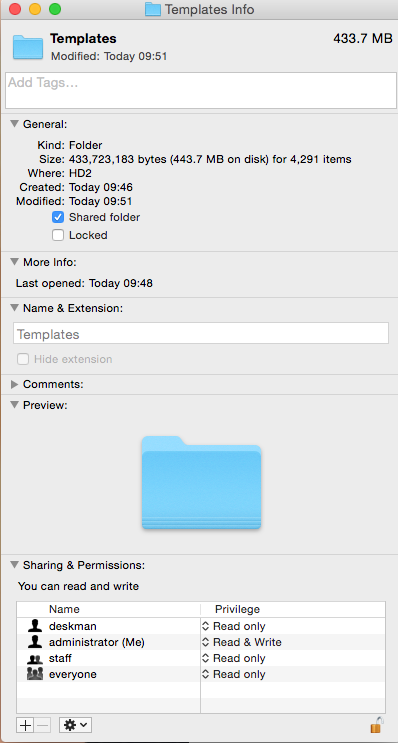

The info for the share clearly has my user 'deskman' having read only access and share folder is ticked.
Client is Mac OS 10.9.5 , Server is Mac OS 10.10.5
If you aren't using an authentication server, the accounts on each of these machines, although named the same, will be interpreted as different accounts. Try the url below - maybe it will work:
Code:
smb://macserver01\deskman@macserver01
