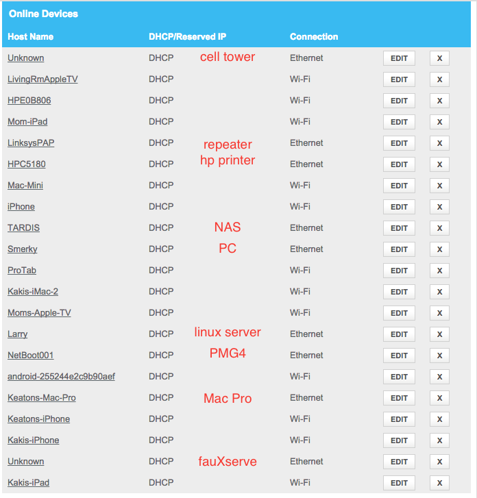

Ok, so I'm stuck. I have the Farallon iPrint SL (for my StyleWriter printer). It came with a straight through cable, but since I'm using it with a hub, I am using a standard ethernet cable. There are status lights on the iPrint, it shows its connected to ethernet and connected with the printer. I am using Leopard, and I cannot see the printer anywhere on the 'Add Printer' page. Any ideas? I cannot seem to track down a manual anywhere on the web.
Here is a list of ethernet devices on my network.
The G4, fauXserve, and linux server, are all on the same switch as the adaptor.

The G4 cannot see the printer. Neither can the router.
