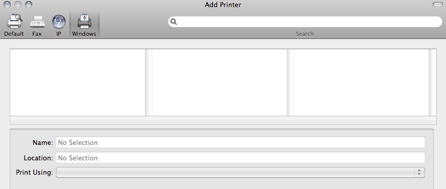

Under File>Print>Printer:Add Printer... can you see the printer at all if you click on the Windows tab?

Nope, that's the weird bit.. In Vista, I can access the shared files on this Mac. On this Mac, I can connect to the Vista machine (Go -> Connect to server), and check the shared files over there. So we're in the same workgroup for sure (even made an unique name for this workgroup, and both Vista and OSX use that workgroup name), yet I can't spot either of the printers at all 🙁

Oh, you can just connect them to the hub? Neat. I'll try that at some point then, but for now I seem to have got working for the HP printer, though I would've preferred the Epson, since it's way better quality than the HP.
I pretty much just added a new button to the Printer windows, called Advanced, and configured it so it connects to the IP of the Vista machine. This fixed it for the HP, but the Epson gives an error when I try to print. I tried reinstalling the drivers and even installing the CUPS drivers, but nothing seems to have worked so far.
Also, I'm not sure how long this will work, since the IP will probably change at some point. Though I guess I can fix that by adding the computer name of the Vista machine instead of the IP.
