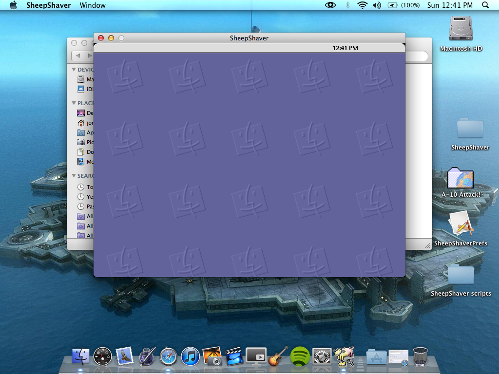

I'm trying to get SheepShaver to run OS 9 in OS X Leopard, and I got everything working, but when OS 9 boots up, it hangs at the desktop for a minute before it loads anything. I've tried everything. I deleted all the invisible preference files, reinstalled OS 9, deleted the PRAM values, tried different RAM and window sizes, etc. Nothing works. It has worked fine before, except for the occasional freezes because of CPU hunger. My CPU works at 100% when this happens. After about a minute, it does load everything, but what do I have to do to stop these hangs? Also, when using the built-in preferences editor, it saves the preferences, but SheepShaver crashes then, and has to be restarted. Is this normal? I am using the October 2009 build, since the newest February 2014 built crashes and won't save changes, although it supposedly works with Tiger and Leopard. Thanks in advance,

Now for whatever reason, Sheepshaver won't even start, even with all the preferences configured properly. Strange. I just get the "?" sign, but it won't boot from anything.
