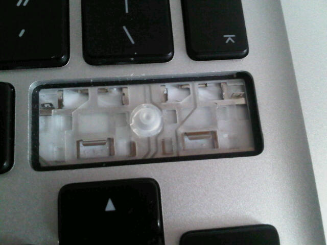

That was the best answer i have got in a while, perfect, i will have to look into it before purchasing it. here is a picture if your still curious what has gone:
Funny, but that looks ok to me. 😱
I know I fix computers all the time and never had this before, anyway will get the new keyboard and let you guys know, but I have to do my deep examination to see why is that.
