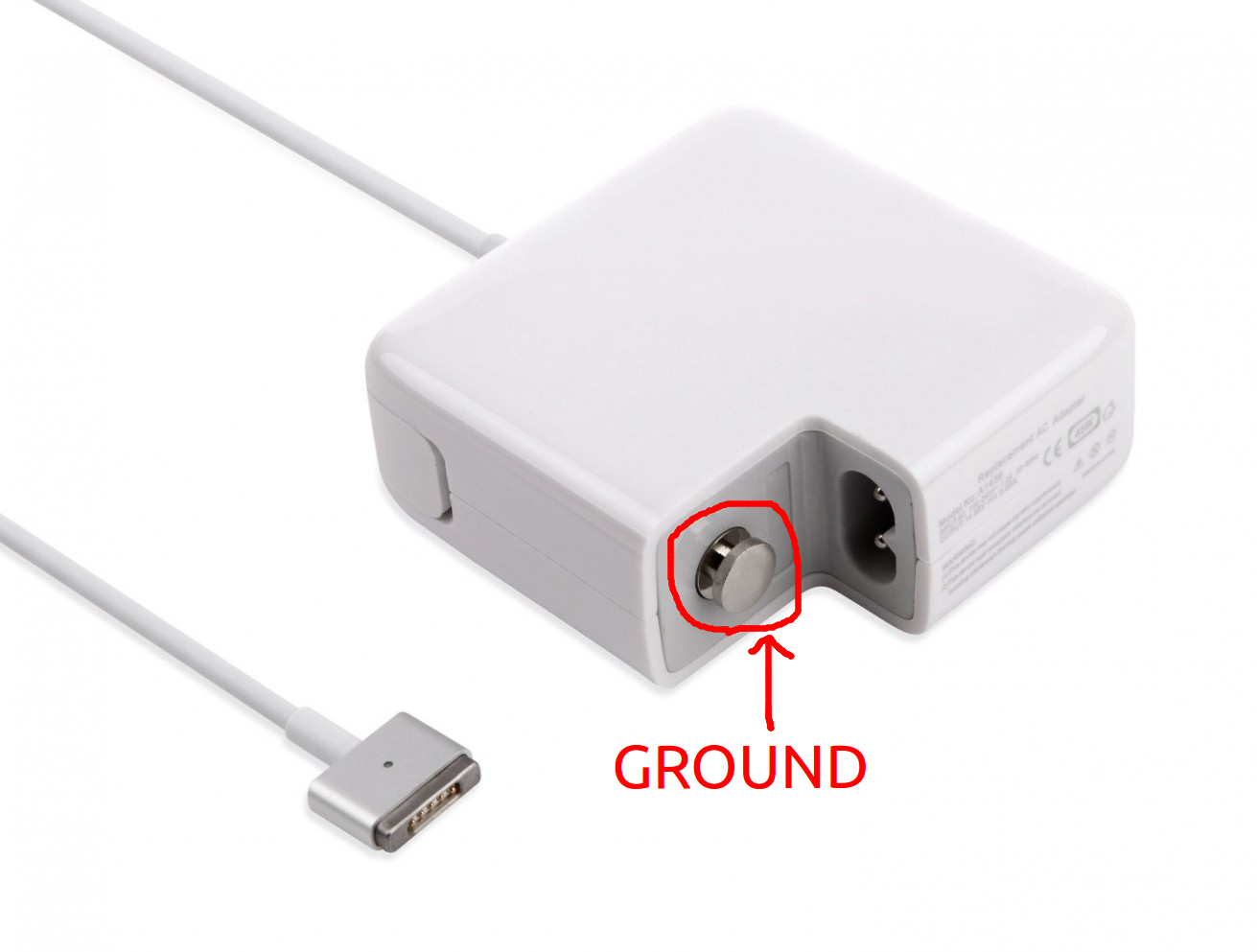

Even if you put a three prong cable onto the adapter, it won't be grounded because there is no ground on the adapter.
The adapter itself is grounded.
That's what this metal ring is for.

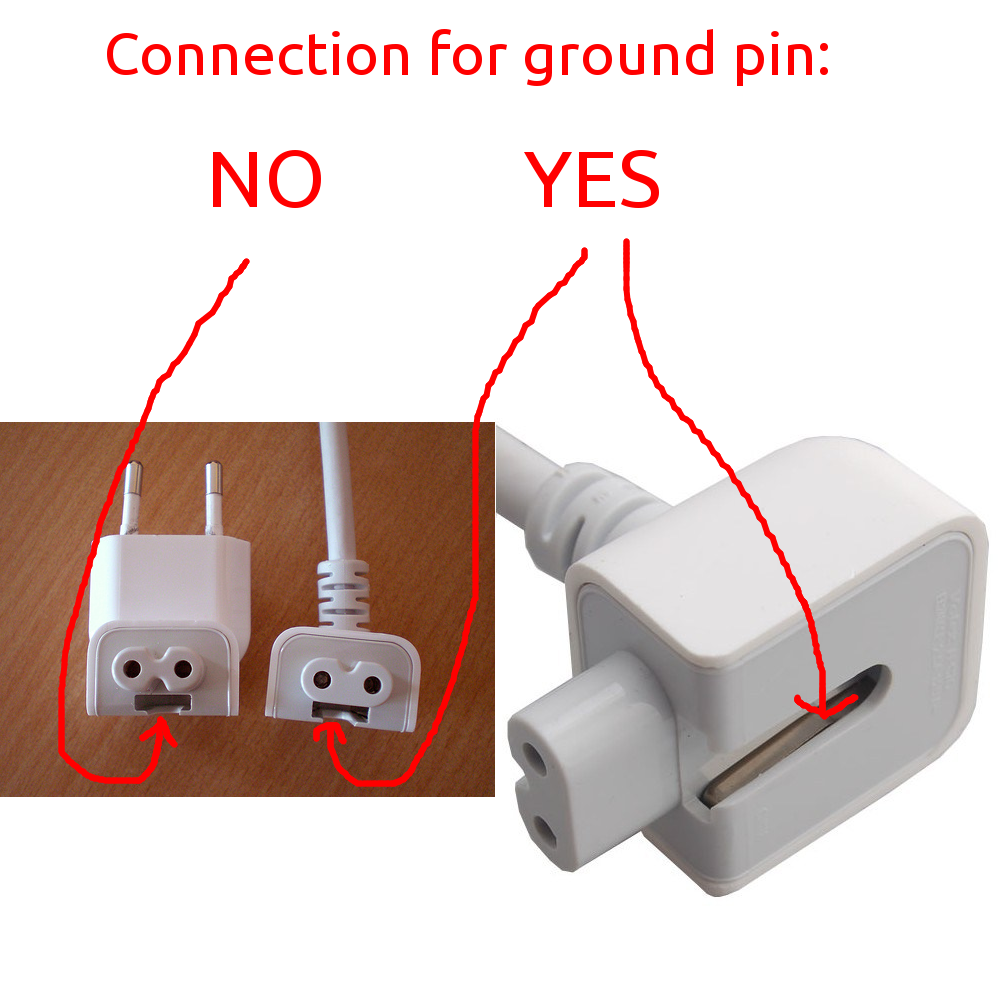

But the short plug that comes with the adapter has no grounding. Even though it has 3 prongs for the US models because it's not connected internally. The extension cable you can buy from Apple has that.
You can check that if you look inside the rail of the plug. if there's no metal contact inside the rail, then the grounding pin is not connected and is just to hold the plug in the socket.
Thanks. Yes, this is why I’m looking for a short way to ground it for U.S. use. Does anyone know of a way to do that in the USA except with the long Apple cable?
