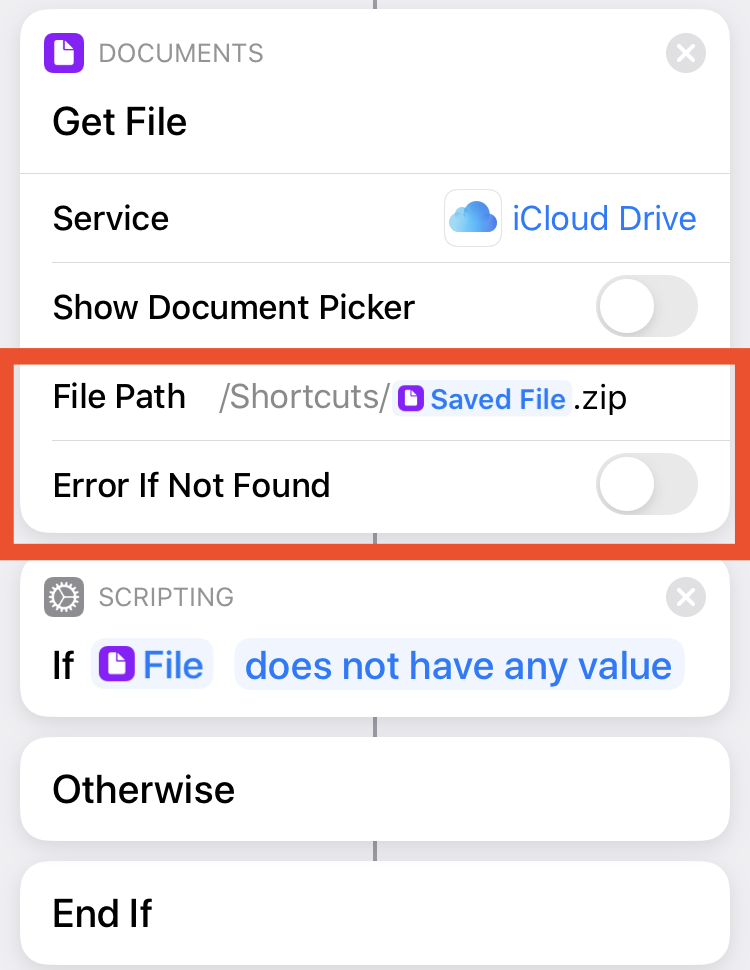

You can try getting the file afterwards with Get File. It already has a toggle for showing an error and stopping the shortcut, turn that off and add an If.
Make sure you add a ".zip" to the end of the file path, otherwise it won't find the file.
This is on iOS 13, should still work similar on 12 if you're still on it.

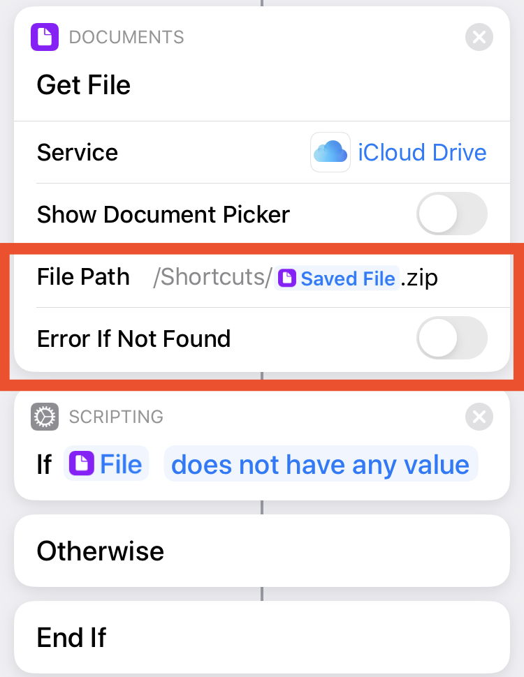

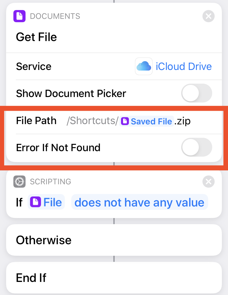

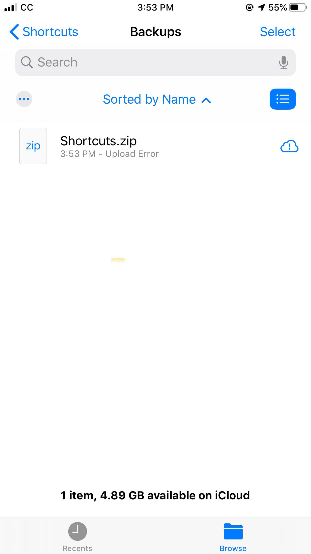

Tried your suggestion using the Get File action/If statement (with WiFi off), but it did not work properly.
If NO file exists your routine works fine, however in my situation the shortcut ran and the new file was created anyway.
The Find app shows the new file with “Upload Error” indicated.
See attached.
