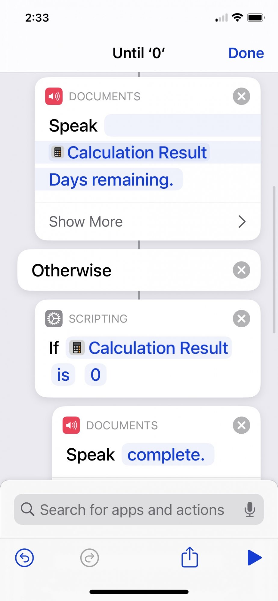

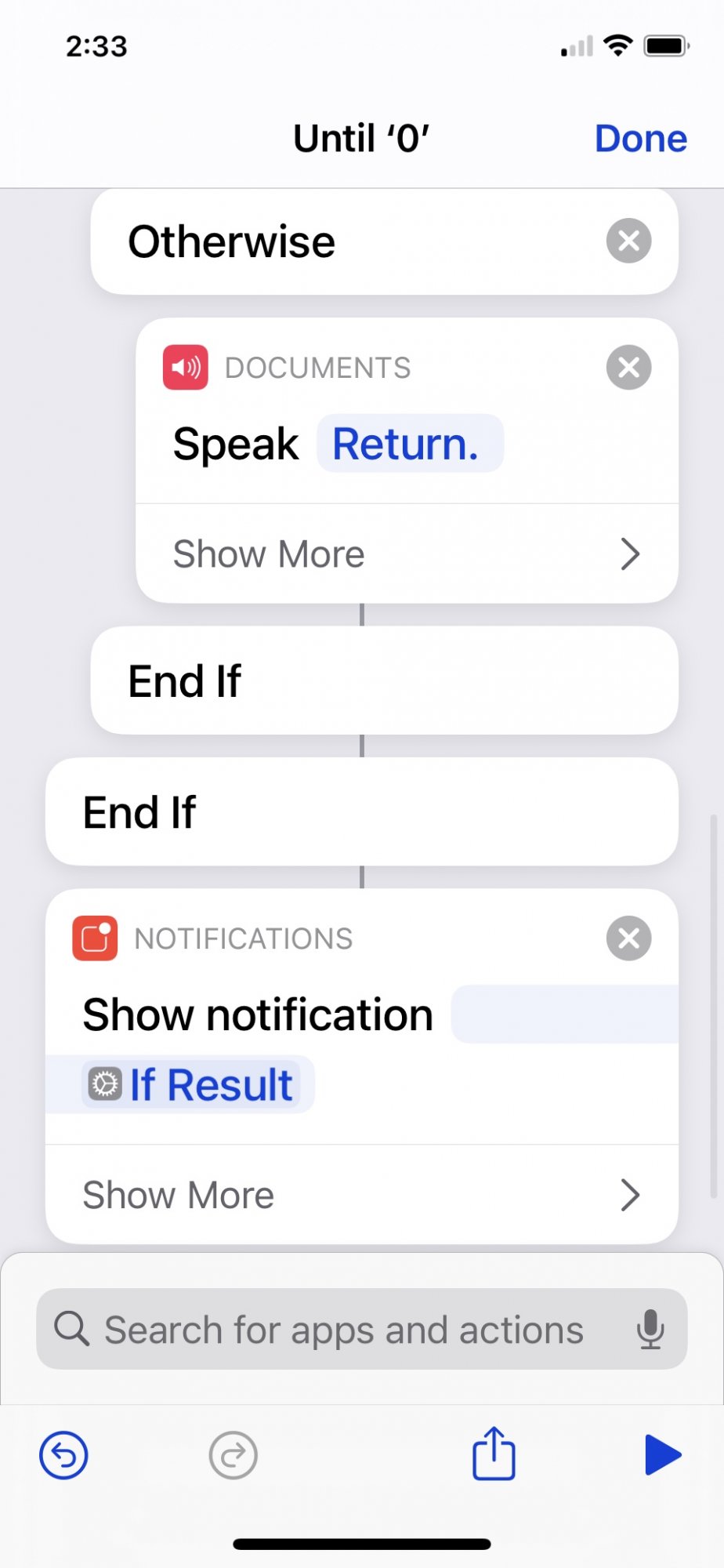

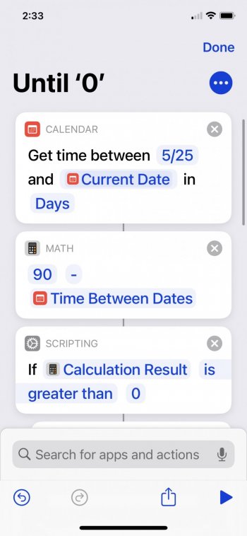

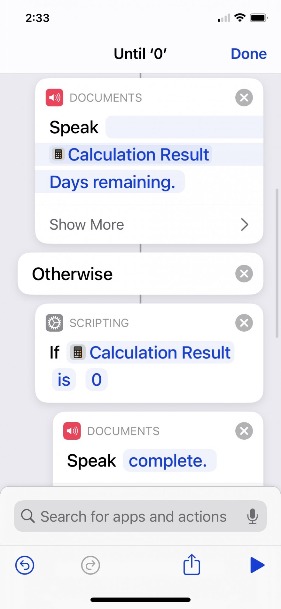

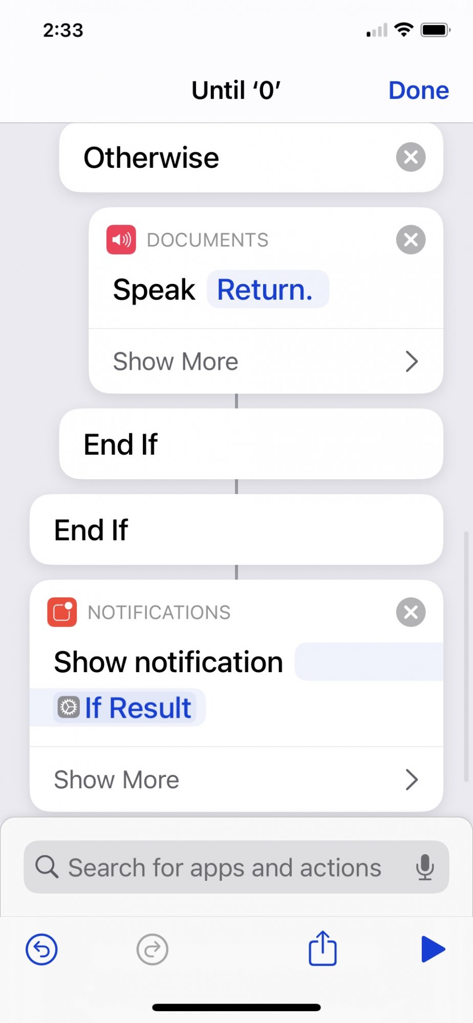

hi does Shortcuts scripting recognize negative integers?
Im trying to trigger an 'if statement' with a calculated result:
if >0, say A
if 0, say B
if <0, say C
in my shortcut:
before 0, I get A.
at 0, I get B.
but after 0 (less than -1, -2, etc), I get A again. (instead of C). X
OK, so I solved my scripting issue by using an 'if statement' that is either >0 'A' or 0 'B', anything else would result in 'C'
BUT still curious about an answer to negative integers 😉
Yeah, it supports negative integers. It's just you're using two plain numbers in math, so you're saying 90 - 3, and basically the negative number cancels out the subtraction and it becomes addition and so you get 93.

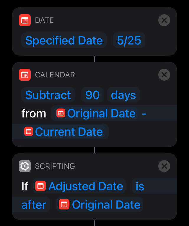

There's an action called Adjust Date that you need to use instead of Math. Math just sees the input as a number.
How long ago/Until is related to the current date, it's going to give you text like "3 months ago".
In adjusted date it's,
Subtract 90 days from 5/25 - Current Date
Then it's,
if adjusted date is before 5/25, this
if adjusted date is 5/25, this
if adjusted date is after 5/25, this
Add the date as a separate action and when you first use it rename it so it's more readable (you can do this with just the shortcut input too).
It's going to give you the actual date, so you'd use the get time between if you wanted it to announce the amount of days left in the 'if date is before'.
