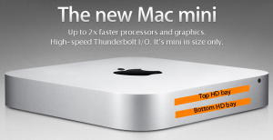

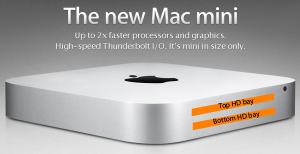

Don't confuse people, the slot that's easier to access is technically the LOWER slot (that's how it's identified in Disk Utility). Some people only think of it as the upper slot because it's on top when the unit is inverted so it can be opened.

I just knew this thread would lead to the "Ole upper-lower" confusion.🙂
One vote here for SINGLE SSD in a Mini. I base this on temperatures that can happen when a 2 drive Mini is put to hard core tasks for longer periods.
This lead to some confusion back in the day.
Here is a photo I posted some time ago in another controversial thread.
Think...
Top = upper
Bottom = lower
