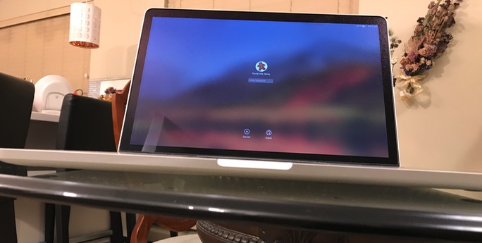

I just found out that my Late 2013 Macbook Pro 15" had a hard to press track pad and battery bulging on keyboard and bottom. The stat shows Normal and 330 cycle counts.
So, I went to Apple store to get the battery repaired.
The genius told me that the battery swelling happens with ALL devices with Li-ion batteries that is constantly charged. Yes, I do use it as a desktop mode with cooling pad at the bottom. I do cycle once a month. He said overcharging is the cause of the battery swell.
^^^serious question, how does it get that bad before noticing/doing anything about it?
I put it behind my monitor, so I really do not know when it started. It's really hard to tell. One year back, I remember the keyboard marks on the screen. That might be the first sign. You really don't notice it until trackpad stops working and Macbook gets wobbly.
I did not realize until I tried to format it and give it to my family member.
I was very lucky to actually to take it out to inspect it. Otherwise, it could have been just growing and growing behind my monitor.

I am just lucky to check my Macbook visually at this time. There is no warning on my rmbp. It is "normal" with 330 cycles. It is dangerously bloated to the point of bursting at any day. (two front feet are off the ground in the photo) I am surprised with that much bloating, no warning sign.
