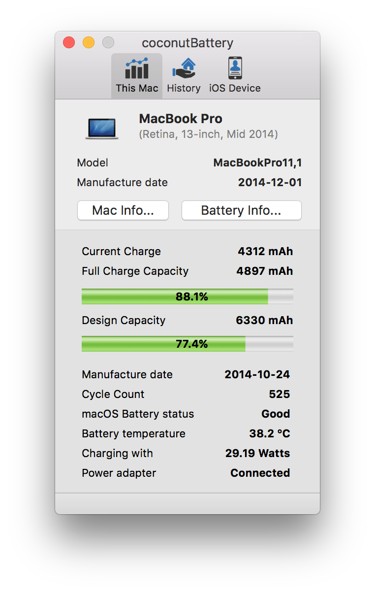

I got a late 2014 13" MBP retina that I bought in earlier 2015.
My mac currently only holding 77% of original design capacity.
My current charge cycle count is 525.
Should I worry about the battery?

No you should not worry. Unless you seriously need to work away from mains power for extended periods your battery could be fine for years yet.

As I'm a student, I don't leave my mac plugged in all the time because I'm taking it to my uni. Most of the time I would used it until it is not usable anymore (0%). I guess that's not good for the battery right?

It should not matter, use it as normal.
The battery is intended for it.
The battery will last more years if you plug it in when possible, if that's what's you're worried about.
Hmmm, so do I leave it plugged in even when full 100%?
Yes, I do plugin my mbp when I have the chance it's reducing the charging counts on the battery.
And then just leave it plugged in.
But really I don't think about it when I'm home it's plugged in , when I'm away I use battery sometimes when I'm home I use battery etc.
I don't really care I swipe mbp every third year and so far the battery have been good all the time.
YES - that is NOT within specifications, which to my understanding is about 80% of original capacity at 1,000 cycles. I would take it to Apple, where they can perform a more accurate test. If their test shows the same result and you have AppleCare, I think they will almost certainly replace it free of charge. Even if you do not, while their warranty on a defective battery is only for one year, such accelerated wear may still result in them replacing it free-of-charge as an act of good will.
However, it is also important to note that this application may not be accurate. If this is accurate, you should be getting only about 3/4 of the run time that you got when the device was purchased new. This is why you would need to have it tested by Apple.
Okay thank you for your advice, I will send it to Apple as soon as possible.

Remember that Apple wants you to replace the battery when it gets to only holding 80% of the charge. So if your battery worked for 5 hours and now it works for 4 hours, they want you to replace it. Of course if you have apple care and they will do it for free, then go ahead.
If you do not, then its perfectly OK at that level, and it will cost a lot less than the $200 replacement to buy an external battery that plugs in like your mains and gives you a huge amount of time, and is only as big as a portable eternal drive.

OP should definitely take it to Apple, hopefully he has Apple Care so they'll replace it for free. I took my laptop in for a full checkup like a month before my AC expired, I was really hoping they would at the very least replace the battery but of course they didn't. What ultimately did mine in was a trip to a cousins wedding where the high during the day was 106. Within a month I was getting service battery warnings.
Take it to apple when you have time and state it's under 80% .
Though , even in its current state, are you getting good battery life ?
