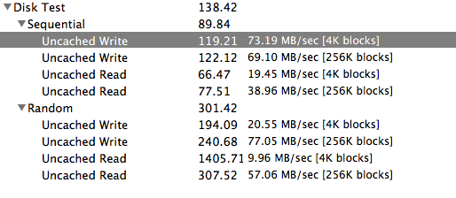

Got around to installing the SSD and 2GB RAM. Here are the results according to xbench. To me these seem correct for an SSD running on an ATA interface. What do you think?

Looks good to me! It seems you're close to the 1.5Gbps max for SATA I so at least you know the SSD is working well. How does it feel in actual usage?
It's great! For a ten year old computer it is handling everything nicely. The SSD made a bigger difference here than it ever did on my iMac G5, which is odd but fine with me since I plan on selling the G5 soon anyways.
