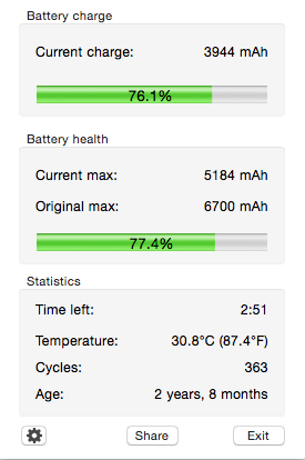

I own a Macbook Air 2012 i5/8/256 13", which I bought in November 2012 brand new.
Just wondering if I should go and replace the battery. I have the service battery warning shown in the battery monitor. I mainly use my computer for facebook, youtube, streaming of tv shows online, photo and video editing, and traveling. I'm actually going to be traveling pretty soon for a few months. But I'll be using the macbook air mainly in my accommodation, and on the plane for light photo editing.
It hasn't really bothered me all too much to be honest, and I haven't gotten to the point where I wished I had the extra battery life. Even then, when I had my Macbook Air brand new, I was only getting 5 hours of battery life out of the 7 hours advertised. I used it on medium brightness settings for the most part. I did manage to squeeze in 3 episodes of the walking dead when I was on the airplane before the battery went out on me.
Just need thoughts and opinon. Battery replacment is $129 + Tax will round up to $140

I have the same Air as you and I recently replaced my battery. If the only option was paying Apple to do it I wouldn't have done it because the cost for me wouldn't have been worth it. If you want to do it yourself replacing the battery is very easy. All you have to do is remove a few screws and detach one ribbon. I paid $55 plus shipping for my battery which is the same model A1405 that came in my Air when I bought it new.
Thanks for the reply. Right now, my battery is only at 77% maximum capacity out of the 100% when I first had it.
I'll just stick with my current battery. Just can't justify a $140 battery replacement by apple at this time. and I don't have time to order a battery online and do it myself because I'm leaving the country.
