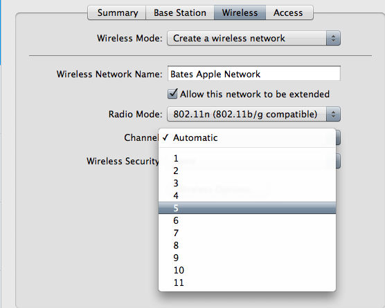

Yes, I have all cordless phones. Where in Airport Utility do I change the channel? I don't see an option for that in Manuel setup....thanks for the reply 🙂
UPD: Wait, I found the setting. I have it set on Automatic. There are also the options 1-11. Which should I change it to?

AU->(manual setup)->Airport->Wirelsss->Channel (probably set to automatic)
Play around with it for a bit. If you can't find a better channel, your phones may need replacing.

I have now tried all 11 channels (and Automatic, which I have always been on). I called my house when I had it at each of those channels, and of the internet still goes out. I also tried unplugging all of the phones in the house, then calling, and the same problem occurred.

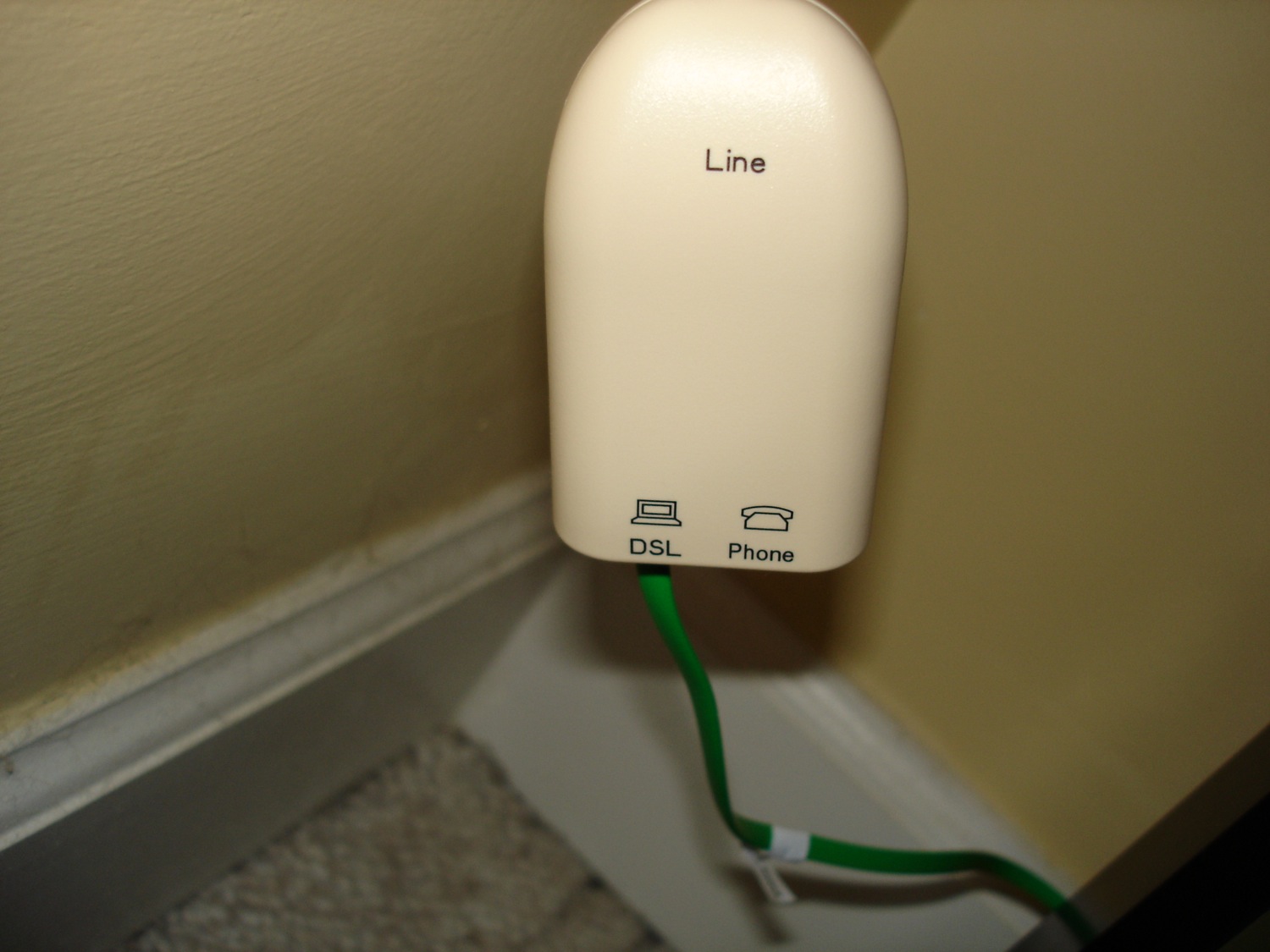

I have the kind of filter (picture below, I don't know what its called) on every phone in the house & on my modem. I have checked to make sure the phone line is connected to the correct side of the filter. (This is the modem filter)

I do have a filter everywhere in the house. I have replaced all of them after this problem started occurring.

Try 1, then 11, then 6.
I'll try that, thanks.

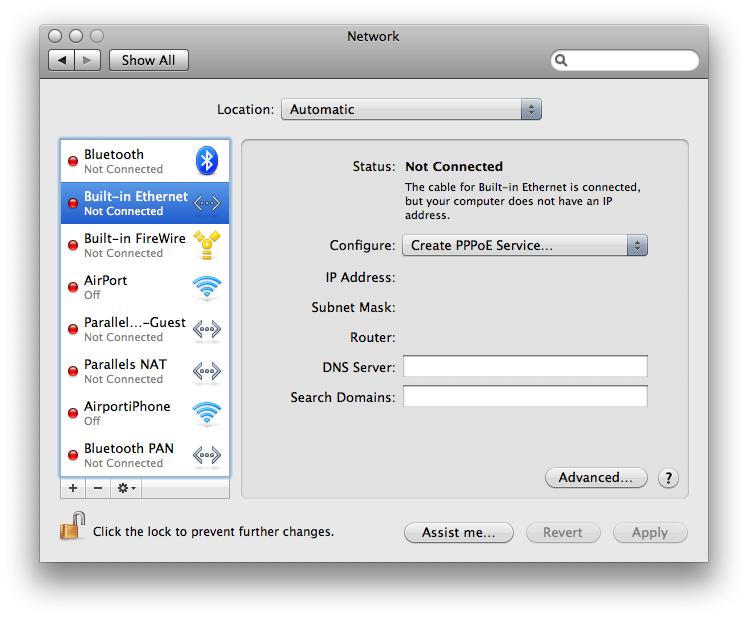

Ok this is what comes up when I connect using Ethernet (picture below). It doesn't assign me an IP address at all. For one second, I noticed it said something like "Ethernet cable disconnected" under status without even doing anything. I only happened once and I wasn't quick enough to get a screenshot. Maybe I should try switching back to DHCP (even though the phone still cut out when the phone rang)

Well, that screenshot shows that the interface is down. Try changing it to DHCP. Also look at the link status light on the router for that port on the switch.

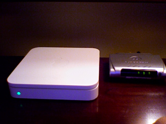

The router is the AEBS and the modem is a Motorola. (sorry its backwards, photo booth)

Ok, so the motorola guids say set your Mac to use DHCP, so do that.
Now when you plug in your Mac to the Motorola device, if the link doesn't go active in Network Settings, and the link light doesn't light up on the Motorola devce, then something is broken.
Try a different cable. Try a different computer with the Motorola port, try the Mac with a different piece if networking equipment i.e. plug it directly into the AEBS.
That should hopefully help you identify the dodgy piece of equipment. It would make sense if it was the Ethernet port on the Motorola device, as that would explain the AEBS showing a dropped connection
