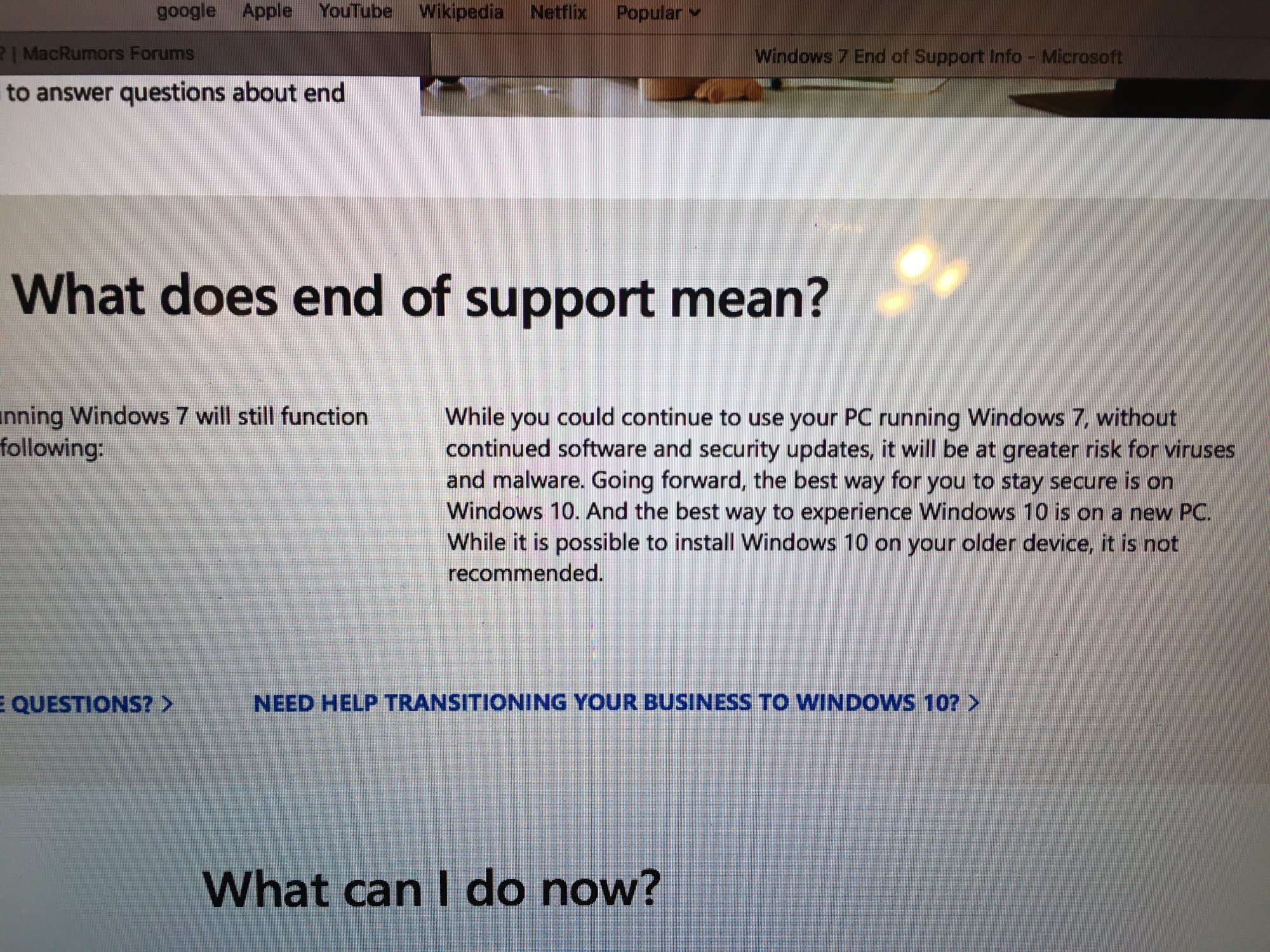

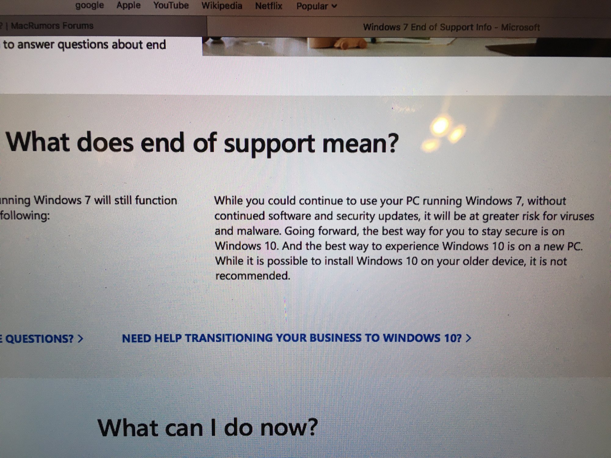

I think I ran that app, and was told I needed to go to 10 first. However, I believe I would have to purchase 10, since no “free” support.
The machine has no personal files on it. So nothing to save.

Doesn't hurt to try upgrading to 10 Home to see if it's still free. Worst case you'll just get an activation watermark nag in the lower right corner of screen but it's functional. Make sure you're not connected to the internet when booting into 10/11 for the first time to use local account vs having to use Microsoft cloud account and to personalize Windows for dark mode, wallpaper, etc.
