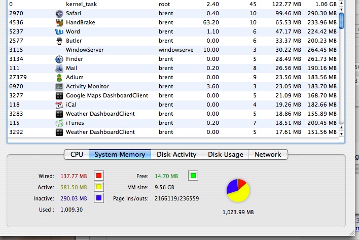

I do a fair amount of video editing, some medium level photoshop work (in photophop elements). Some webdesign with Dreamweaver. I probably go back and forth between power user and home/email user several times a day. I rarely have more than 100MB of memory free... heres a current screenshot:

Another useful question is... do you see "load dependent beachballing?" That is, sometimes, you get a beachball because of issues in the way an app is coded. Like sometimes, especially with pages that have javascript, and so on, Safari will beachball tabbing between tabs even when it's the only thing running. But do you see beachballs that occur specifically in times when you are pushing the machine hard, whereas the same would not occur if you did the same specific routine with less other things going on?
Your profile sounds like you need the ram, but your free memory indicator isn't a very useful piece of information -- OS X will try its darnedest to use up all the memory it can. Most of that is replaceable stuff -- that is, the system can immediately dump it and use the memory for something else, if it needs to. The problem comes in when all the memory is being used by stuff that cannot be dumped, and you have to page out to virtual memory.
If you really want to get into it, you can also go and look at your page-ins and -outs.
But if I were you, I'd go buy the RAM. 🙄 😉 😀
Where would I find this and what should I look for? Is this different than the pagein/outs thats in the picture I posted above?
Also, does adding more memory drain your battery any faster?
Eeep, no, they're one in the same. But I don't know how to analyze it. 😱
Someone (probably Trevor) posted a guideline somewhere in these here fora on how to interpret them. It's mostly the size of the page-outs, I think, that is important.
Anyway, if you can afford it, go snap it up! 😀
I found something helpful in one of the linked articles in one of the threads. In terminal, if you type in "top", it gives you a live readout of whats going on with pageins/pageouts. The numbers in parenthesis about 6 lines down show how many you've had in the last 1 second. The article said if that number is constantly between 25-50, you really need memory. 😀 Just sharing the info, maybe somebody else can use it

Activity Monitor doesn't seem to show the Pagein/outs for the last 1 second. It shows disk activity for the last 1 sec, but this is different from what it is showing in terminal, from what I can tell. Am I missing something?
