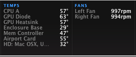

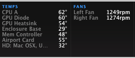

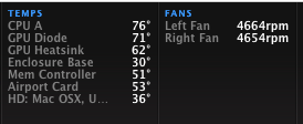

here are some images to support this
this is with the battery installed, running on AC, running 100% load doing rosetta on Boinc

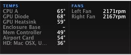

sorry to make three posts in a row but its necessary to separate the images for the test
look what happens to my temps when i removed the battery, i didnt power down i just removed it, im still doing 100% CPU load on both cores
my CPU immediately dropped 10c (really odd) and i lost my enclosure bottom reading

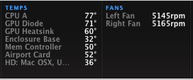

now as soon as i plugged the battery back in my temps climbed back to 76c in about 10 seconds
