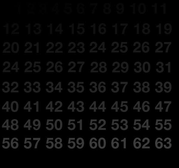

Yes it does.
Take this black point chart for an example.
Without calibration, values below 20 were not visible at all.
After calibration, values were visible till 15.

This is totally misleading. I have both the 15" Retina and 27" iMac and on both Apple's profile, they don't look the same.
Does it say anything that I can see up to the 7,8,9 on my iPad (3rd Gen)? I know the screen is regarded as phenomenal as far as its sRGB profile.
Yes it does.
That's when brightness is at maximum and the black does not appear as deep anymore.
Regarding the iMac value at 15 is cause I calibrated mine to native luminance and the xrite is compensating for current ambient light.
I see. So when my 27" iMac shows up, I should probably expect to not be able to see below 20 with a normal brightness setting?

The test photo you're using, what value does the test call for? Those images ask to adjust your screen 'until 10 disappears etc..' not more numbers the better.
To be able to see the gradients of shadows and highlights clearly when you do editing and subsequently outputting them to prints. With the right paper, printers are able to print as dark as roughly 10 but how are you able to tell if your monitor is uncalibrated and you are unable view it?
The purpose of calibration is to have a controlled workflow whereby you can see the same exact details during post processing and printing.
Same here. Out of the box, using Apple's profiles, they don't look the same. After calibration, they do look the same. After all, that's the whole point. :)

Yes it does.
Interesting. On my entirely uncalibrated 24" ACD I can see all the way to 12.
So let's say you calibrate and you could not see below 20. Now you can see up to 15. That's great. So you use those colours for some effect not knowing if people will be able to see what you've done on their screens. It seems a bit silly.
