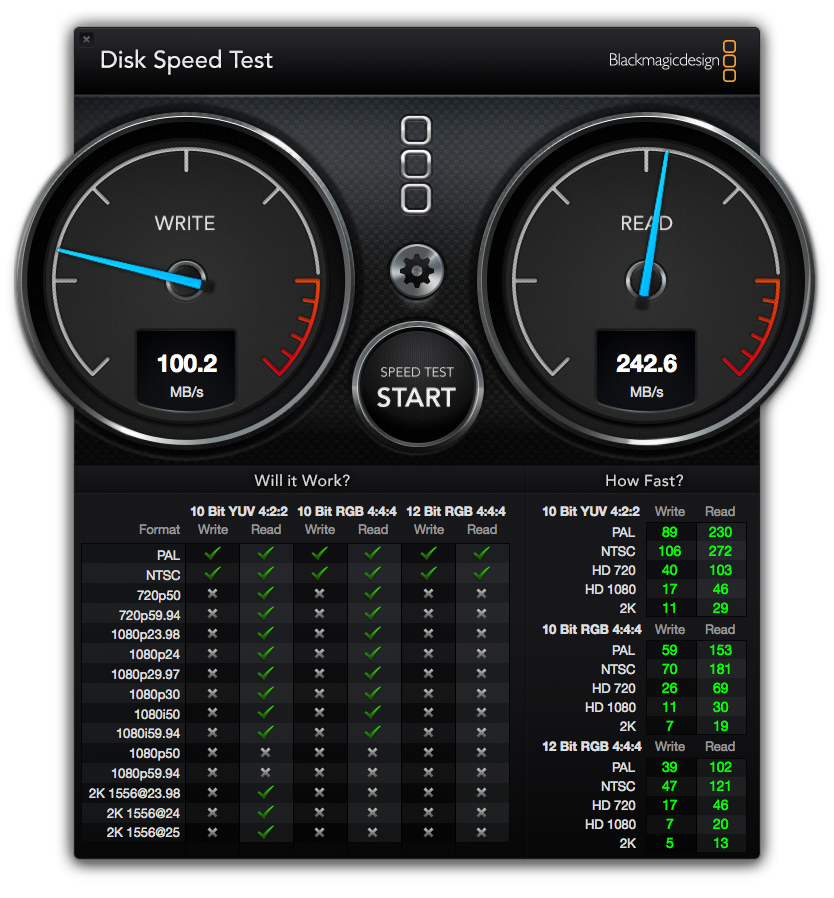

I don't run VMs from USB3, but I have run one from an SD card with "ok" performance. With that said I'm going to test running a VM from my USB3 flash drive (32 gig Sandisk Extreme) as well as run Black Magic against it. Will report back when done.
I copied 12 gig worth of Ubuntu VM to my flash drive and ran a few things - firefox, software updater (downloaded 114 meg), rebooted etc. It's not as fast as internal storage, but it's not slow either.
Attached is the result of running Black Magic.
