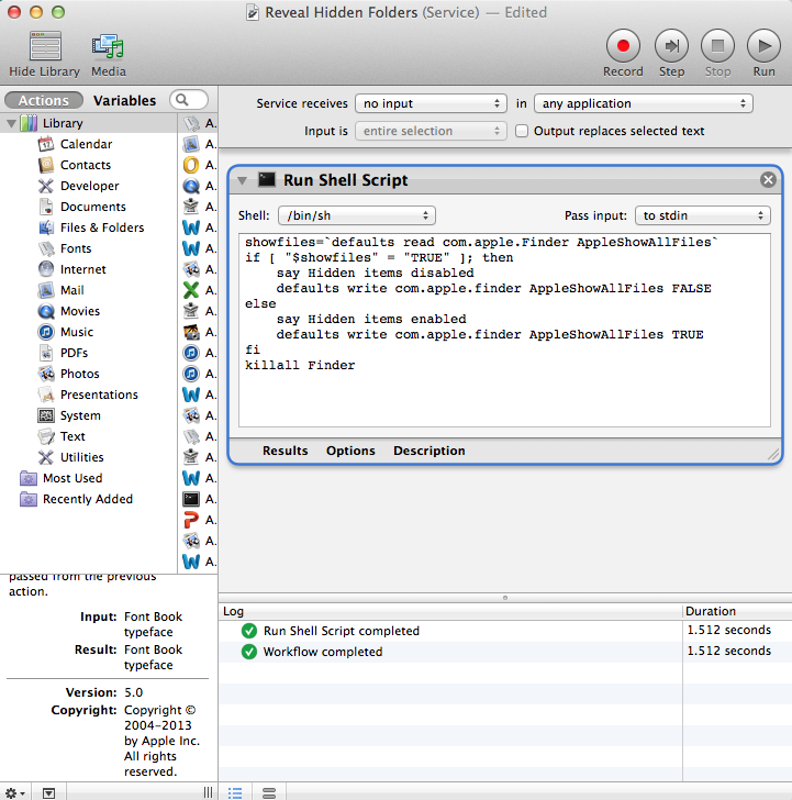

Still not working for me either... FYI just as others have mentioned, it works well on computers where I upgraded to Mavericks, but with a clean install (erase first) it no longer works. I have tried all permutations of caps, no caps (and have read all the threads)
UPDATE: I was able to get this working using the automator script suggested, but I DID have to insert a killall Finder command after the if loop. All of this seemed to magically start working after a restart of my computer. Handy little service, thanks for the post! This is what I did in automator...
First select New, then Service, then using a "Run Shell Script" action, copy in the text suggested above and save it (it will automatically be saved to your Service folder). Assign a unique key combo and you've got an awesome shortcut.
