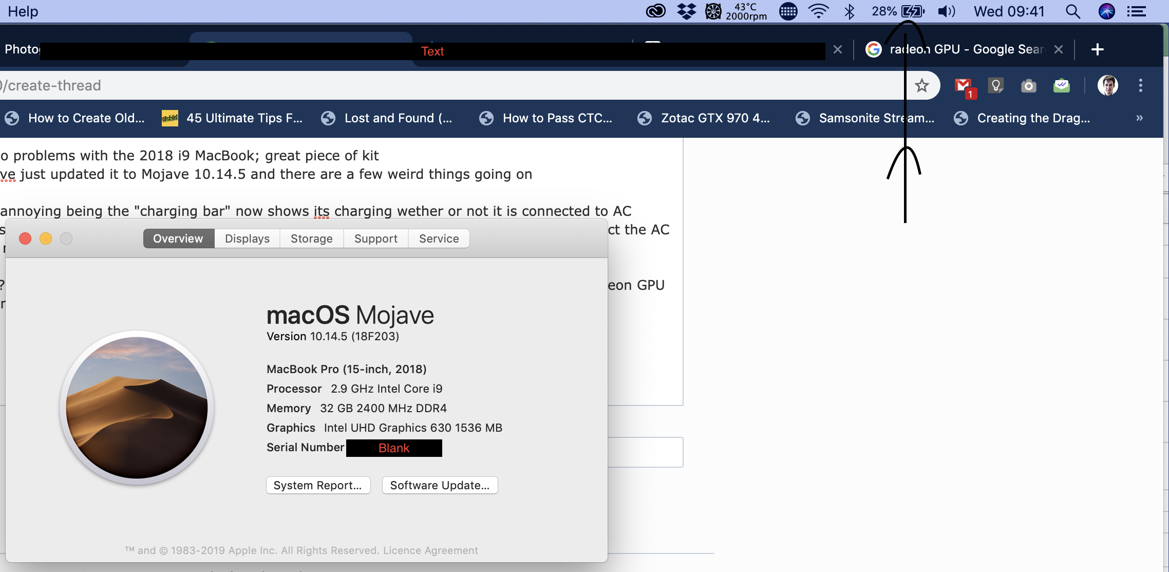

I've had no problems with the 2018 i9 MacBook; great piece of kit
However ive just updated it to Mojave 10.14.5 and there are a few weird things going on
The most annoying being the "charging bar" now shows it's charging wether or not it is connected to AC power. Its going down from 28 to 27% but showing charging BUT its not connected.
When I do connect the AC adapter it makes no sound to indicate this and the logo stays the same.
Any ideas? Also on this section of the "about this mac" - should this show that its actually got a radeon GPU rather than the internal chip? How can I test it is utilising the GPU.

Also it'll show whichever GPU is being used, not what it has. So as it's using the iGPU, that's what's displayed. If you load up an application (Or plug in a monitor) which uses the dGPU then it'll show the Radeon.

"About this Mac" only shows the Radeon GPU when it's engaged. It's completely normal for it to show the iGPU only on that screen. Fire up a game, Final Cut, iMovie, etc and go back to that screen. Should show the Radeon..
As for the charging issue.. have you tried a different port? Different brick? Different cable?
