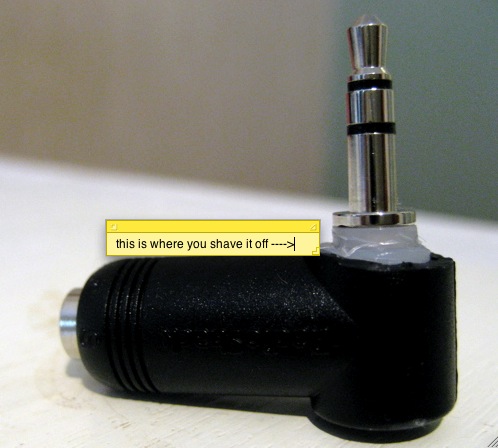

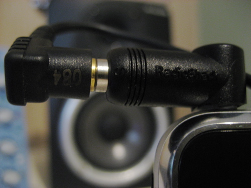

I made my own RadioShack adapter for my e2s. Total cost $4. Doesn't look great, but works great. IMO better than the other "headphone adapters" especially since the shure earphones have pretty long cords already. My solution doesn't add length.
All you have to do for my specific solution is take an Xacto knife to the outer rubber rim and shave off a little bit, thus allowing it to fit inside iPhone's recessed jack.
