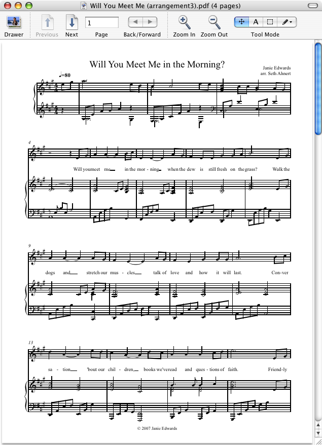

hm, I've had good results with print/save as pdf. If you'd like, once I'm home, I can provide a sample.
I just tried with Print > Save as PDF.
When you open it with Prievew, it looks ugly if you are looking at the whole page, but if you zoom in everything shows up nice and clear. Not sure if this is the issue you are having though...

The Save To PDF option in Sibelius 4 and above does not work properly, and produces blocky looking PDFs (at least on the screen).
There is an easy workaround. Use the Save to PostScript option to produce a PostScript file, and then open that in preview which will convert it into a PDF. These PDFs look fine.

That's pretty much the problem I ran into. I zoomed in and it was still blocky and weird - if you zoom in a lot, the notes look fairly nice and clear, but things like wedge shaped crescendo markings don't look as nice, for example:
when using the "Save as PDF" option, and...
the same marking when using any other export option - whoops zoomed in too much on the second pic 😀
In contrast, the PostScript stuff Sibelius does export, when converted to PDF, looks fantastic.

If you look above at the sample, I do run into a couple issues. And this is the "Save as PDF" option that's in the print dialog, nothing in Sibelius.
