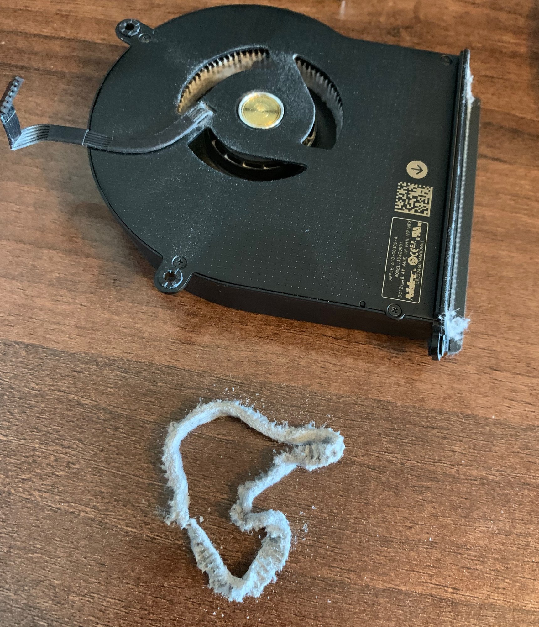

Did you check the fan blades for dust? Something similar happened to my previous Intel Mac, turned out the fan had dusk caked all over the blades. Problem resolved after clean.
Heh, I actually took a photo of that just the other day. Had a ring of compacted dust like this, both on the inside and outside of the blades.

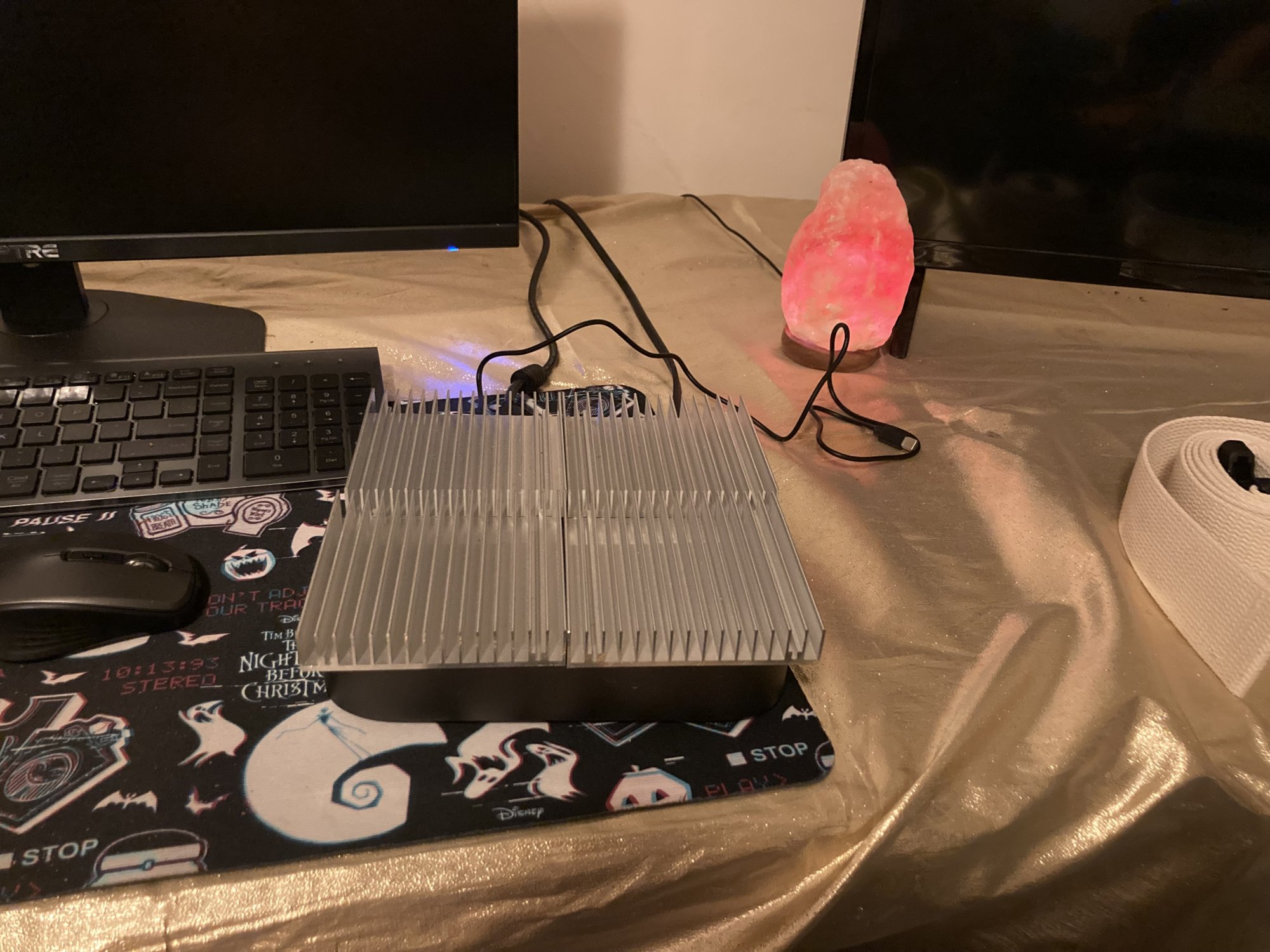

Did you ever figure out anything on this? I'm fighting the heat with Noctua PC fans above and below my 2018 Mac Mini.
