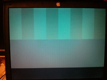

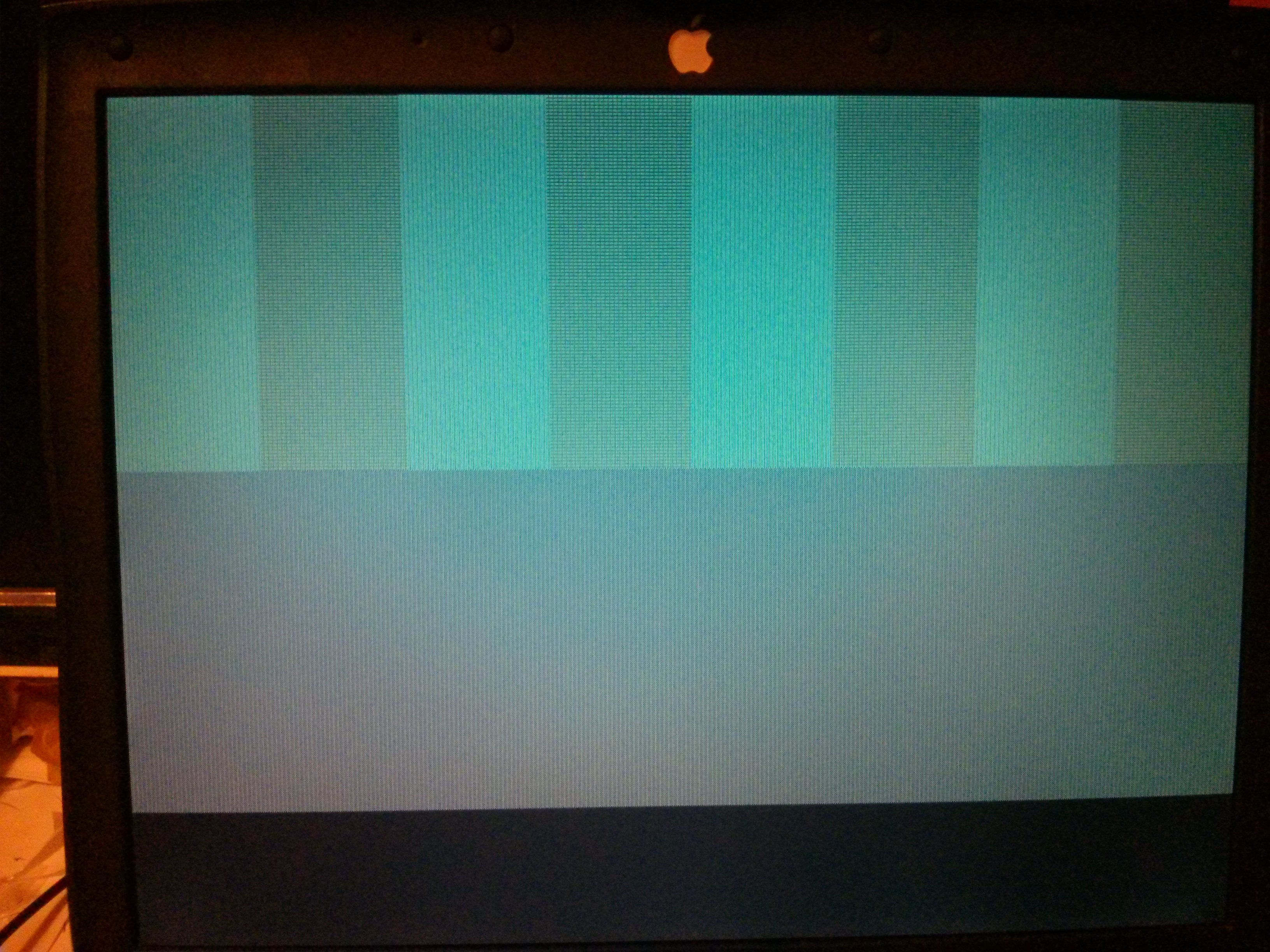

This just started happening a couple months ago. I put it away for a while but wanted to look into it more now. Here's what I see lately when it tries to boot up:

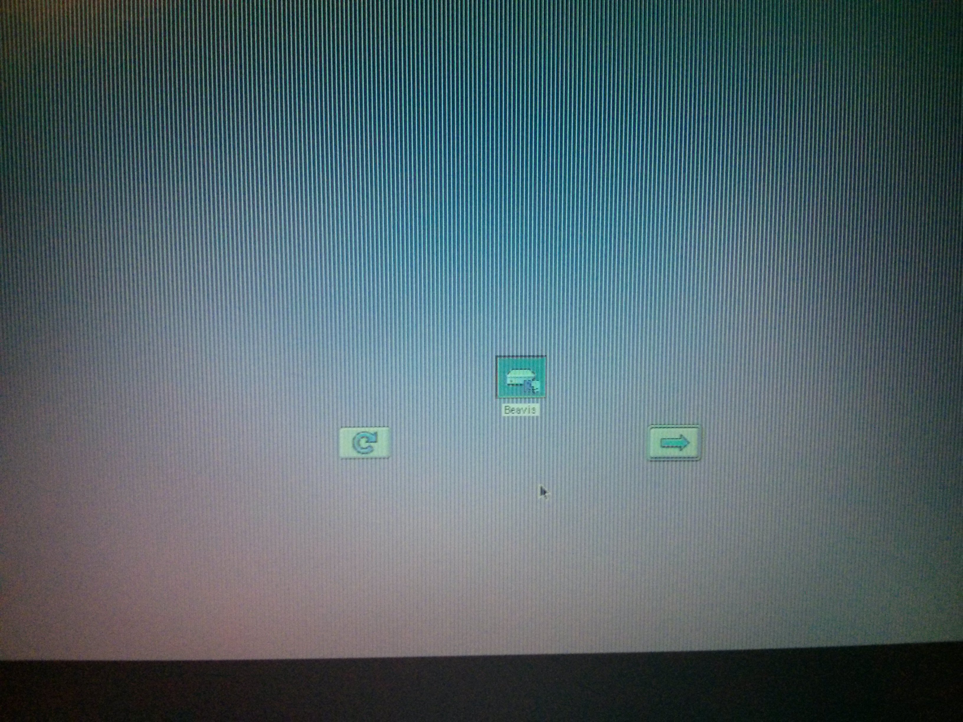

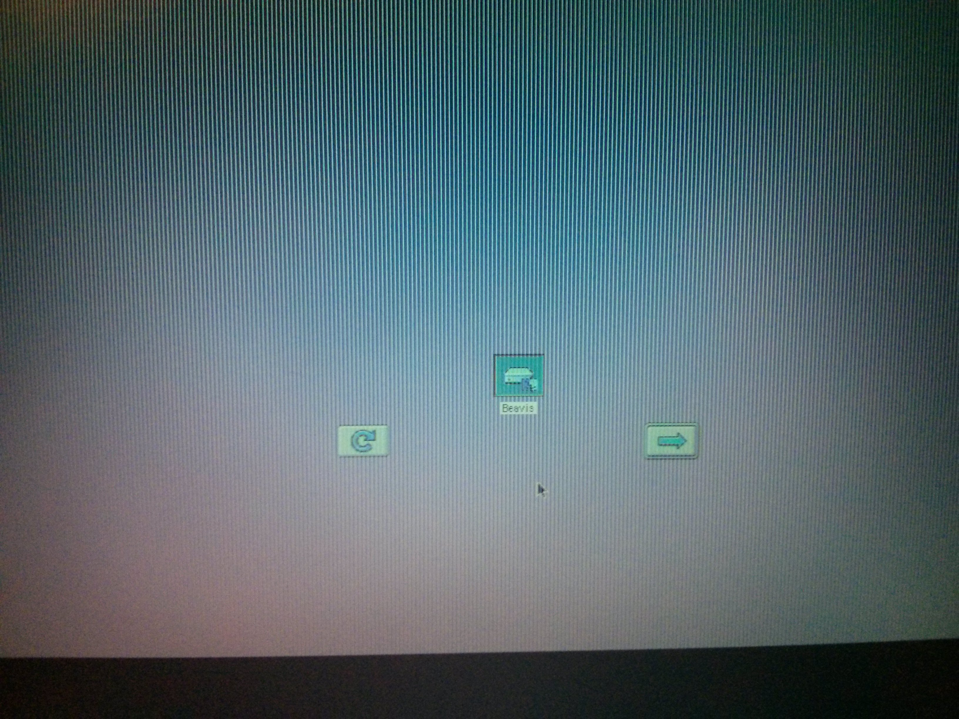

And if I hit the option key while starting up:
And when I select a boot drive it thinks for a couple seconds and eventually just stops with a blank screen in the same color patterns as above.
Before I bother with it more, I wanted to see if this looks familiar to anyone and if it looks like the problem is with anything that can reasonably be replaced, or if this one is going to the "parts farm".
Thanks for the ideas. I tried that to seemingly no avail. I think the problem is different (and perhaps worse) than that, since when I attach an external display to it I see the same type of garbled nonsense on the external display (which I know works fine). I was also able to use the sick Pismo in Target Disk Mode and used it to boot my Digital Audio and it seemed to be working fine to that extent.
So at this point, my wonderment is: Is this something fouled on the logic board itself? If it is, this thing is parts to help rebuild a potential future cheap Pismo. If it's something else that may be more replaceable, I may give it a shot.

It is sounding like a GPU issue. If you have a heat gun, might be worth it to disassemble the pismo, remove the logic board, and blow some hot air over it to get it reflowed. Or, you are looking at a logic board replacement. This guy: http://www.geektechnique.org/projectlab/726/diy-obsolete-ibook-logic-board-repair.html
