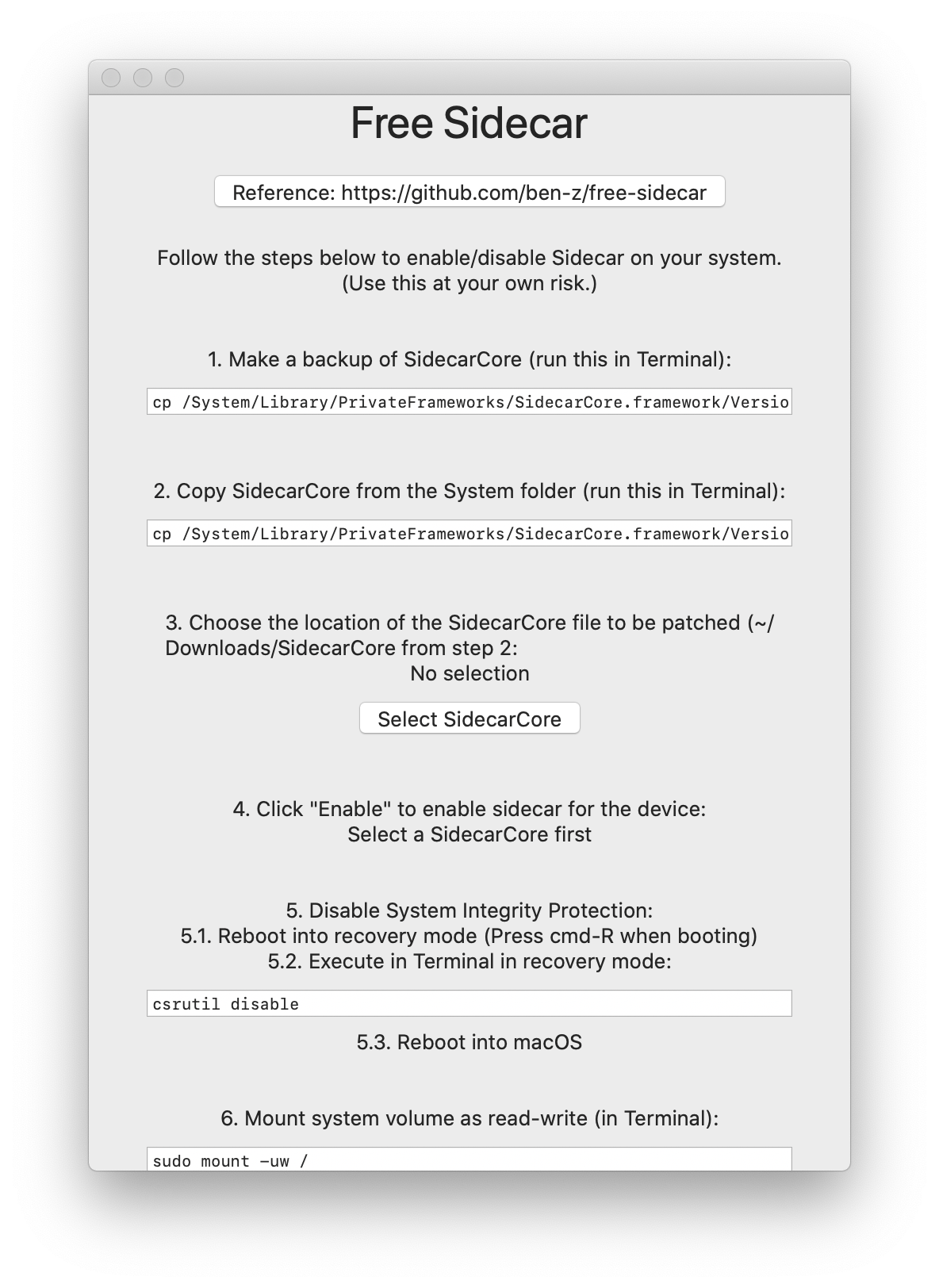

Please don't blindly replace a system file with a patched one from someone else... It might be from an incompatible machine and may screw up your own. When using a patch, you should understand how the patch works before applying it.
Patching SidecarCore is very simple. If you have a hex editor you can do it in no time.
I found that non of the patches I looked at from the internet actually explains how the patch works. So I briefly wrote up the intuition behind patching SidecarCore and made a sandboxed GUI app to help with it.
You can find it here: https://github.com/ben-z/free-sidecar

If you are really so expert, you can easily open my previous SidecarCore patched binary and check it where and how it has been patched, and clearly notice that it can't screw nothing, and I used a supported Catalina Mac so you are speaking of incompatible machine of what?
My point wasn't about how the patches would mess up the system, it was about:
1. People are posting pre-patched binaries that can be system-dependent. In my case, the string in the patch didn't even exist in my `SidecarCore` file.
2. The previous patches didn't explain how the script worked. I wanted people to understand the process instead of blindly running a script with sudo. That's why the app in my repo is sandboxed and doesn't require root access.
IMHO a pre-patched file is much more handy than a patching on-the-fly of busy and constantly used frameworks/kext by the system that can cause issues during that process, or even a failure in replacing signature, SidecarCore has many system dependancies, try to delete it or wrongly code-sign and check if you can open Notes.app from Catalina for example, it will crash, so the codesigning especially must be done carefully and tested.
Again the pre-patched file is system dependent and may not work on all machines. I argue that the file has a higher probability of messing up the system than following a step-by-step tutorial.
edit:
And why you (as also other github developers) provided your Sidecar patcher tool only recently and not before during the early betas when people needed ?
For me, it never occurred to me that the patching was so easy to do so I've been avoiding it. I did acknowledge the original repo (SidecarPatcher, which didn't work for me) in my repo.
If you check here, I guess I was among the first who patched the "iPad Air 2/mini 4" to run on early Catalina betas: Sidecar iPad Air 2 / mini 4 patched file
Good job! But I don't see any mention of the source of your patch? By looking at your posts I'm pretty confident that you didn't just come up with that on your own. And the fact that you didn't mention the source and only provided binary files was probably because you wanted to monopolize this post and have everyone look to you for advice.
The aim of my pre-patched files was simply to avoid the downloading and installation of Xcode-Command-Line-Dev-Tools to others, because it's not only a simple hex-editing but the most important part is the code-signing mandatory to a framework binary in order to be parsed and loaded by the kernel.
That's a valid point! But does this justify not giving credits to the original script and having people wait for you to upload a new file for every release? You are giving people fish instead of teaching them how to fish. Also consider that code-signing might be different across systems. Someone may not recognize the signature that you use and that would mess up their system big time.
The only reason why I didn't explain the method is because others do not asked and to avoid that apple might stop it as they already did with this Sidecar reddit terminal script that worked only till Sidecar beta 2-3 .
LOL that was just a feature flipper that apple put in for early betas when they were testing the feature. It was very likely to be removed in the official release.
