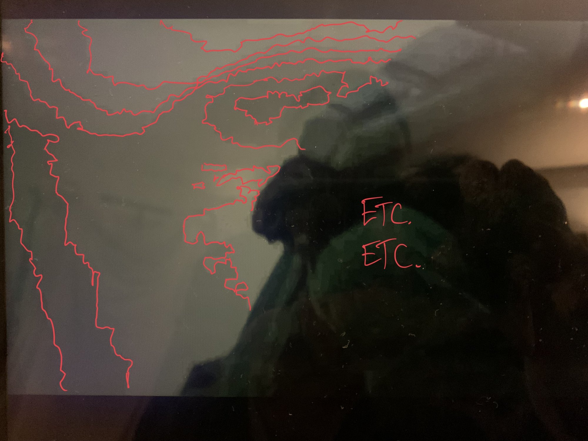

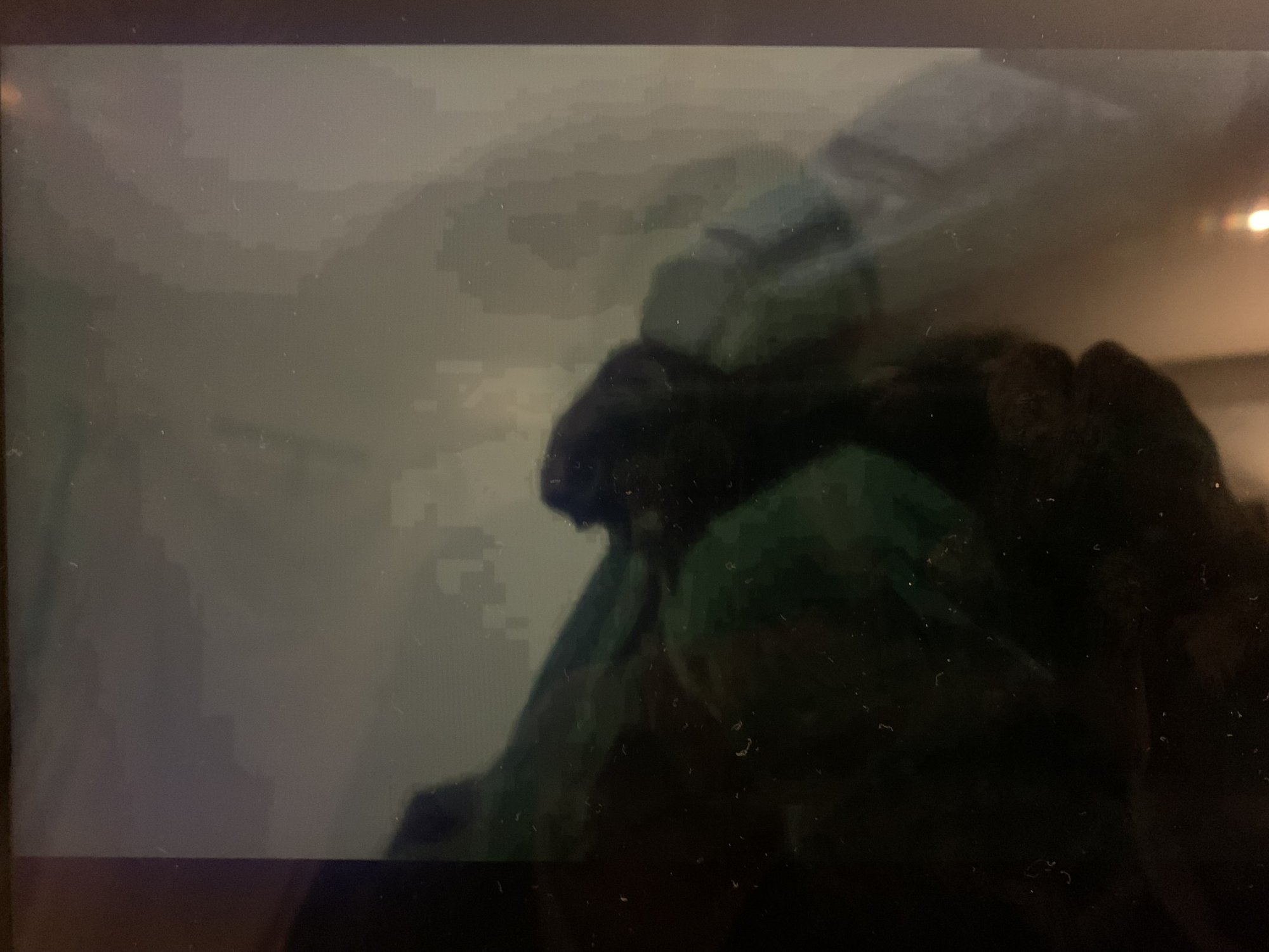

How do you find the quality...it looks very compressed (pixely) to me...
I can confirm above statement, when connecting with TB4 cable it just says USB 10Gbps...although only used the TB cable that's bundled with a Studio Display....
That kinda thing...(2:10:40 from Dune fwiw...though you can see a bit of it even with default Monterey background for example)...
