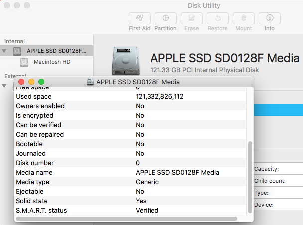

Try selecting the disk like in my screenshot then click info to see the SMART status.

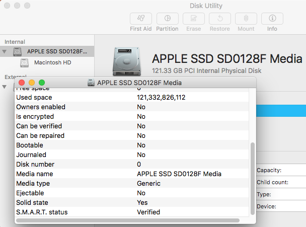

No errors when I command-r and run disk utility first aid. SMART status says verified.
