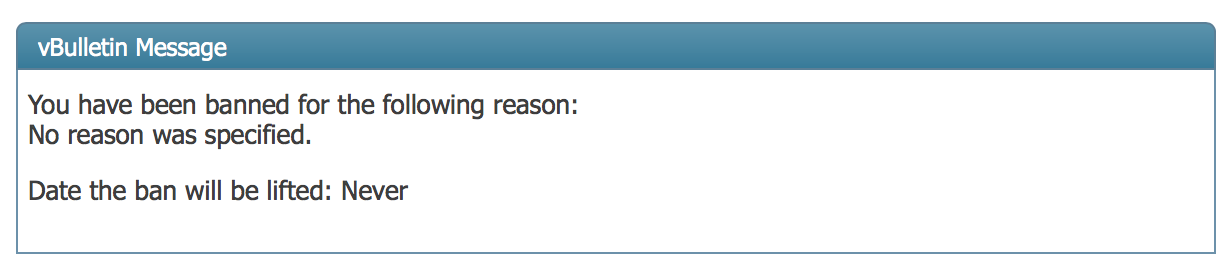

Here's another amazing thing... I joined the Daemon Tool forum, and ask this exact same question. It requires moderator approval before it posts. I wake up this morning to the image below. Seriously?
