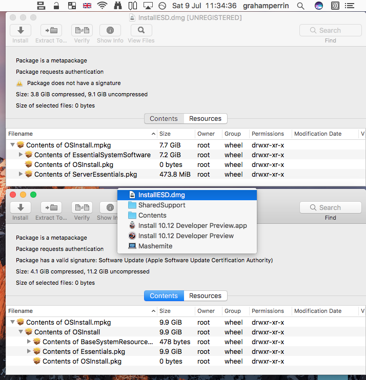

Lion above, relatively large Sierra below (I don't have any other installers handy):
11.2 GiB uncompressed in that view of the installer.
Without inviestigating futher, a lazy guess: AppleFSCompression is more aggressive and/or more widespread than it is in El Capitan.
