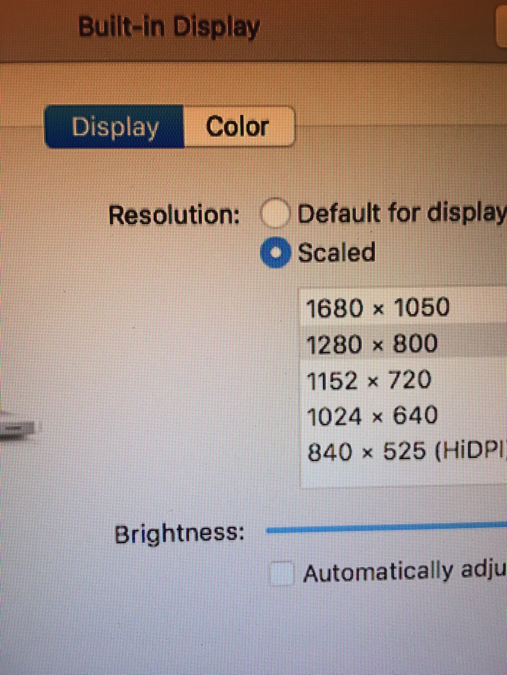

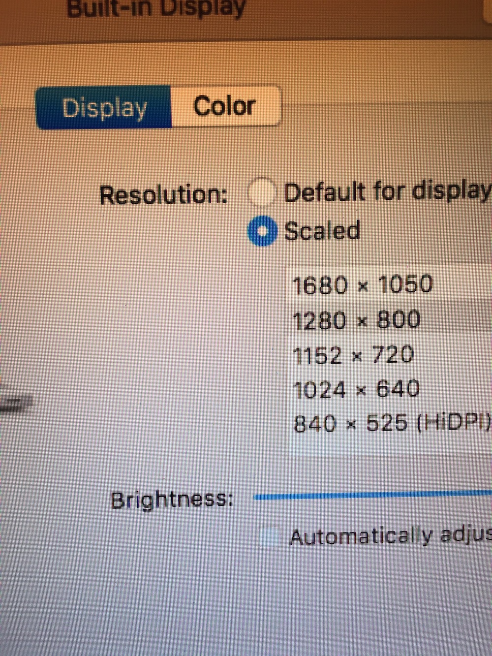

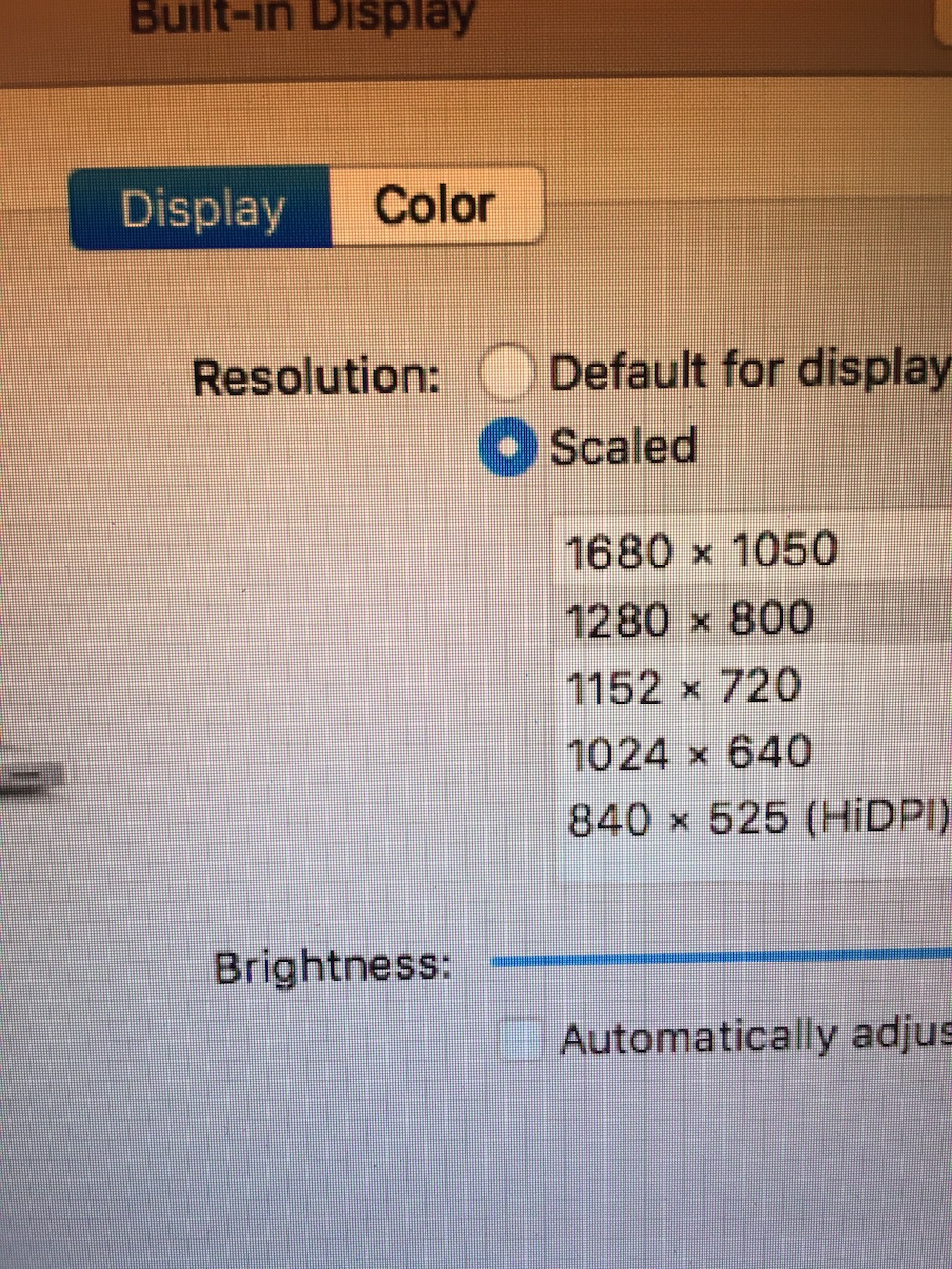

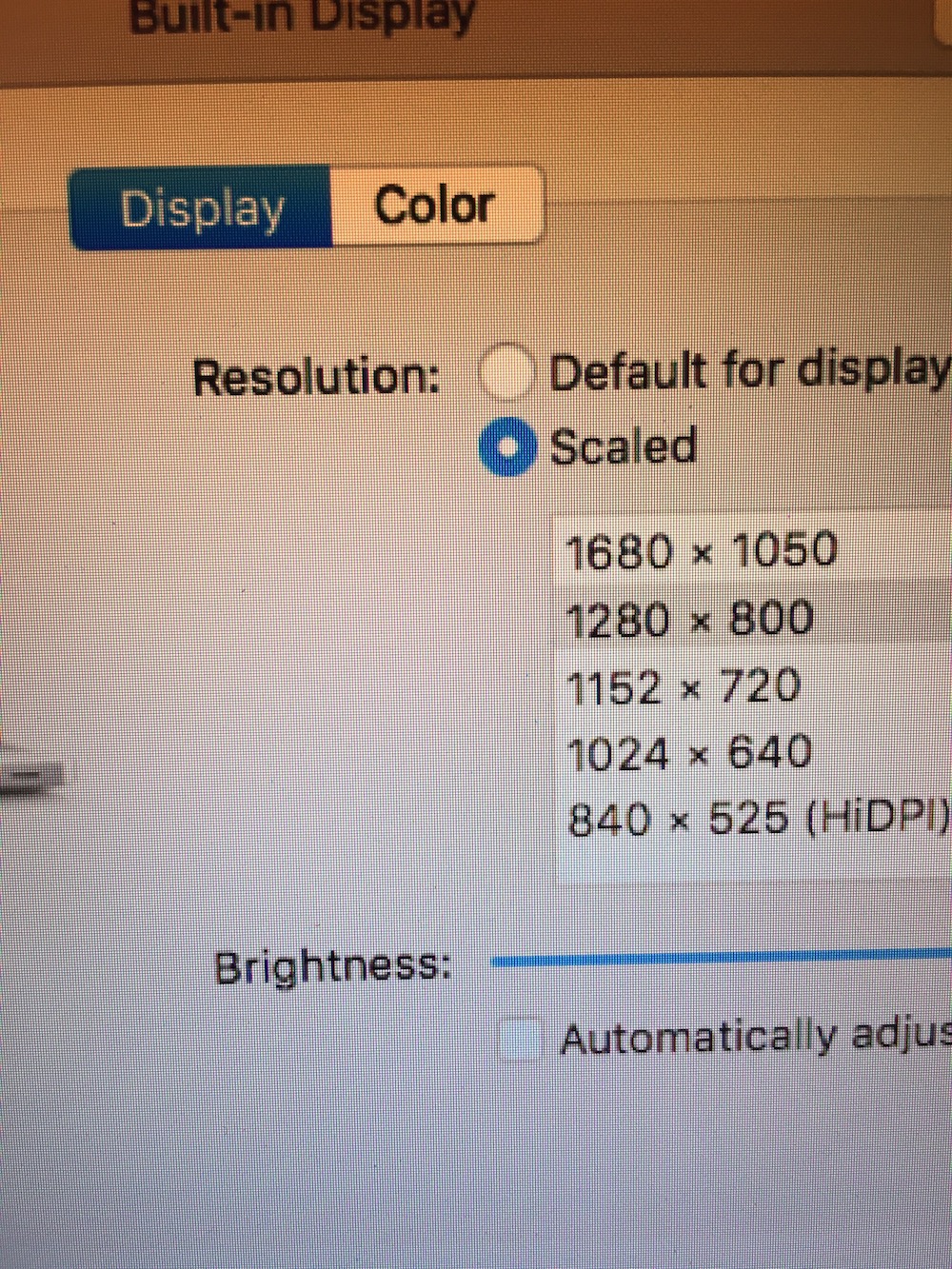

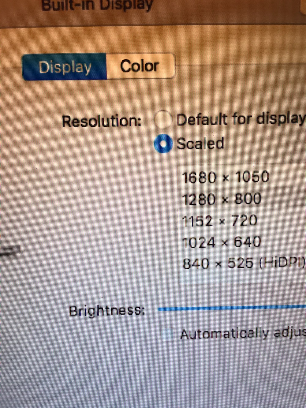

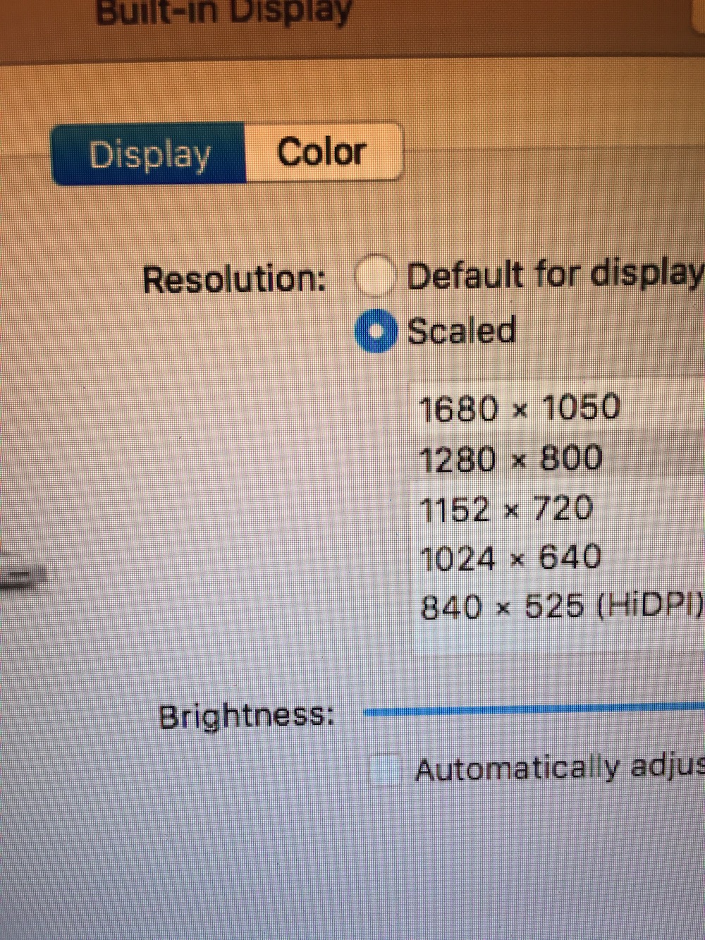

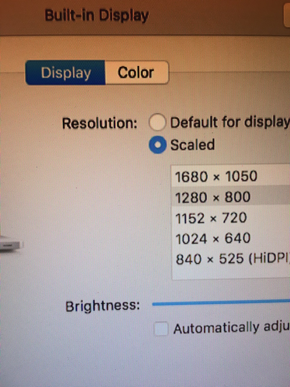

I did some testing with the MBP in my signature, and I am able to reproduce the issue. When running at 1280x800, and with Photos open, some sharpness processing seems to be applied to the screen which affects legibility. Here's photos for those curious.
Normal:
Photos.app open:
Reactions: CreativeSeoul
Normal:
Photos.app open:
I see a slight difference. There's a ringing along the bottom edge of the text on the second image. Obviously a software bug since it only occurs after running Photos. I suggest you leave a feedback/bug report with Apple.
I can't tell any difference in these pics. They both look like they're out of focus just a bit.
Yes, I couldn't really see a difference either. I'll try to see if I can grab a couple of screen shots with SnagIt and post them.
Sorry, it is indeed a very hard-to-see difference, and it probably helps that I have the high-res model. It would be interesting to compare with the standard-res model.
