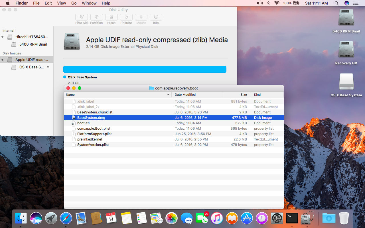

No one in this thread seems to realize the mid 2009 MBP isn't a supported Mac and the Recovery partition does not get patched to work! I have been able to mount it and edit the PlatformSupport.plist file to make it bootable, but there is still the problem of no USB while in Recovery.

I would guess Firewire works fine (unable to test it as my MacBook Air 2,1 doesn't have Firewire), but keep in mind the built-in keyboard and trackpad are connected internally to USB, so you won't even be able to move the mouse while in Recovery. An external Bluetooth keyboard and mouse may work, but I'm not completely sure. I'll have to test it further.
I am not sure what exactly you are required to patch, but if you want you can try to mount the recovery partition from your working macOS with the terminal command "diskutil mount Recovery\ HD". Maybe your recovery partition has another name, therefore look it up with "diskutil list". When you have done this and you have activated the ability to see hidden files you can search for the "/Recovery HD/com.apple.recovery.boot/BaseSystem.dmg" file where all files should be stored that are loaded at a start of the recovery OS. Maybe you can exchange here the respective files as you have done it for the installation of Sierra.

Is more recent Recovery OS 16A239o similarly limited?
(I guess so. Just curious.)
Structured the same, most of the system and kexts are contained in a read-only DMG image. It may be possible to convert to read/write and drop the kexts in, but I haven't tried it yet. This would be a task for @dosdude1.
