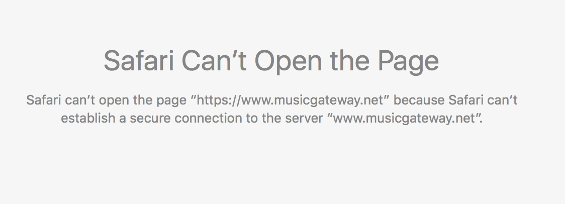

musicgateway may be a different issue... seems to open on one mac, not the other (both running 10.12.1 PB4). weird...

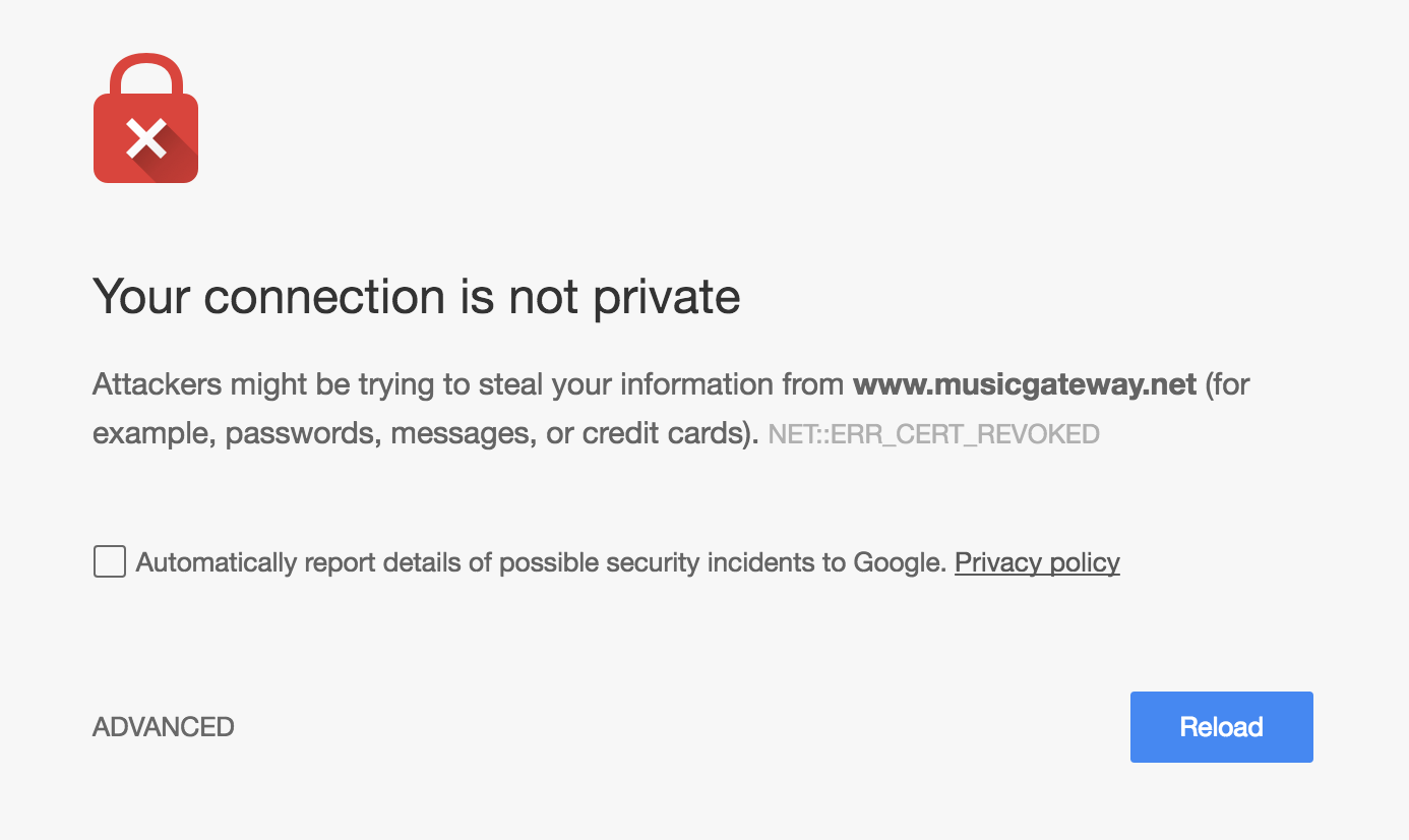

just tried Opera (an impressive browser!) but same problem (and an error about an 'expired certificate')....
What certificate is it saying is expired? the site's cert?
Are you using a proxy on your machine? Sometimes proxies will install a cert as a man-in-the-middle, and if that cert expires you'd experience exactly what you're referring to.
Yeah I'd like to see that cert error. Browsers all handle certificates differently. As an example, Google has deprecated Sha1 certs as being trusted in Chrome and the site won't load, but in IE, it'll load just with a line through the lock.
I'm not 100% sure what Safari does but I believe it also loads the site but complains about the cert.
I see that the 2 sites you linked above are using a Sha256 cert which is current and the official supported algorithm of SSL going forward.
If for whatever reason you and the others are loading the site and it's presenting you with the Sha1 cert, you're going to get cert errors.

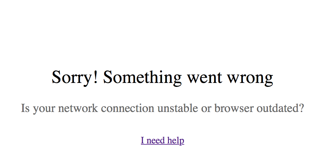

here's what i get (first 2 images from safari, 3rd image from chrome):

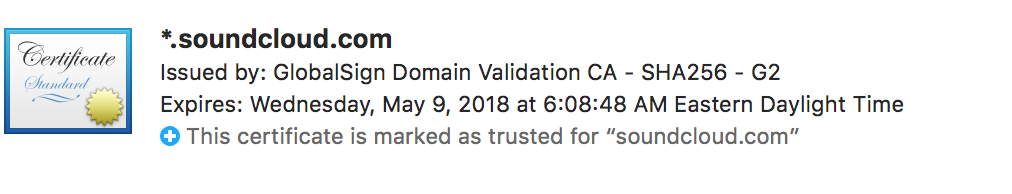

nothing for musicgateway, and the only thing i see for soundcloud is this:

ok so it's a Sha256 cert which is good. I'm not entirely sure why you have it installed however.. you shouldn't ever need to install a website's cert..
Delete it and try visiting the site again.
EDIT: The only reason I can even think of you need to install it is because you downloaded an application that requires you to make an SSL connection into their environment. If this isn't the case, just delete the cert.
EDIT2: Also, whenever you see the "S" at the end of "http", this means you're making a "SECURED" connection into their environment. It's called SSL, and the way you secure the connection is via certificates. Your browser and the site exchange the certificate key and that prevents people from snooping in on your connection. Sha1 has all but been broken, so many sites are abandoning it.

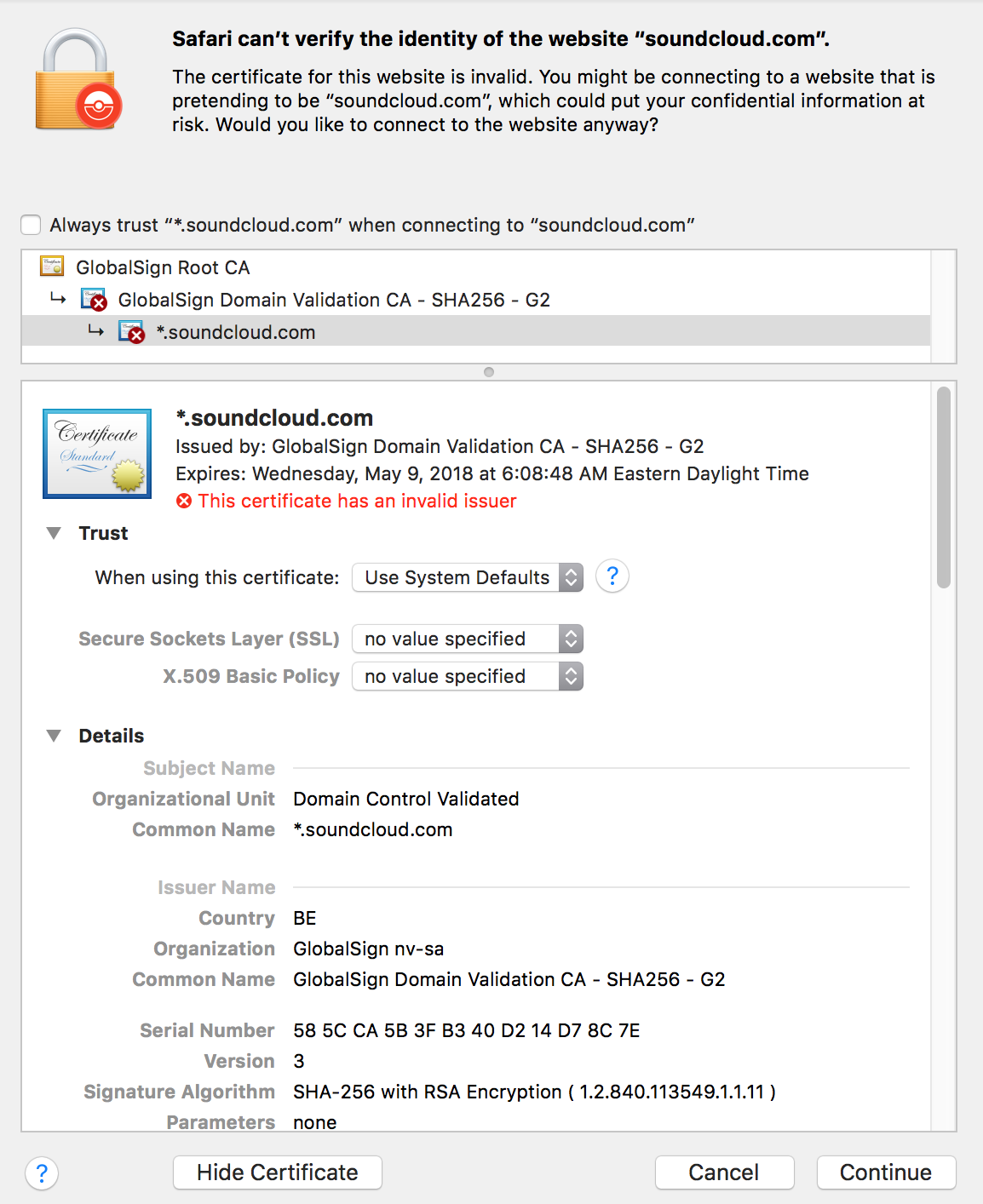

[doublepost=1476463373][/doublepost]here's the soundcloud error:
For whatever reason your browsers aren't trusting the certificate that they are presenting. This is the ONLY reason this is happening. Now, for the reason why your browsers aren't trusting it could be a few reasons.
1. You installed the cert, they are presenting a new cert and your cert and their cert dont match. Just delete the one you installed, you dont need it.
2. You are using a proxy that uses a man-in-the-middle cert. Lots of web filtering companies do this such as Zscaler and Websense. If those certs aren't trusted, then you'll always have an error.
3. Some how the root chain of the cert they are presenting is missing on your machine. You need the entire chain for it to be trusted. Go back to Keychain Access, click on Certificates on the bottom left and click on System roots on the top left. If you don't see "GlobalSign" in system roots, you don't have the full chain and this is a problem.
When I go to Safari and click the padlock to the left of soundcloud.com, and click Show Certificate, I see
GlobalSign Root CA -> GlobalSign Domain Validation CA - SHA256 - G2 -> *.soundcloud.com
[doublepost=1476463529][/doublepost]Delete the certificate for soundcloud.com that you have installed
globalsign is there. and the way i got to see the error message on soundcloud was by first deleting the certificate from the keychain. otherwise, something in 10.12.1 pb4 must have caused this (as others are experiencing the issue). no proxy, no certificates installed)...
