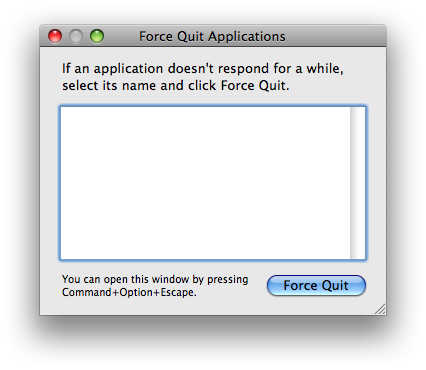

Well, all is not perfect under OS X either. I was just in OS X
and suddenly Finder went AWOL. The desktop icons vanished,
there was no menubar, the dock was still there but clicking an
item in the Dock did nothing. So I couldn't access the terminal
to geekily revivify the system. Ok, I thought, why not restart
Finder? I brought up the force quit dialog and behold:
There's nothing in it! Note: taking a screenshot of it was still
possible. Only the really useful options were impossible 🙂
Anyway, SHIFT+CMD+Q didn't work to logout and in the end
there was nothing I could do but press the power button.
