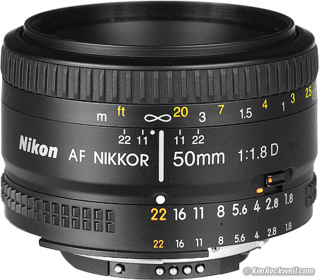

Oh as an aside, can someone tell me what's going on here.
Attached is a picture of the AF 50mm lens I have that I mentioned will not AF on my D5000.
On the bottom of the lens is a series of f stops and I can move that ring. However when it is set to anything other than f/22 and I try and take a pic on my camera, two little red lights flash (within the view finder) and it won't take the photo.
Anyone know why?

Your camera sets the aperture electronically, but you lens (as it's not a G lens) lets you manually adjust the aperture as well. With electronic aperture control on a compatible lens which also has manual aperture control you need to lock the mechanical control on the lens.

Actually slightly incorrect.
the Aperture WILL effectively be controlled on that camera.The lens will not work if the aperture is not set to wide open (f1.8), the notch that controls the Aperture is available on that camera. No problem there.
It's the AF that will not work. The d5XXX and D3XXX series are consumer cameras and as such Nikon decided to leave the focus motor out of them. IF you want to AF on your camera you need to buy an AF-S lens (50mm AF-s, 35mm AF-s etc. etc.)
Did exactly that. Sold this lens to the owner of a D7000 and ordered myself a 35mm AF-S on Amazon.

Yes, the aperture can be controlled on this lens by the camera, but AFAIK, can't be controlled by the ring on the lens. CPU lenses are supposed to have their mechanical apertures locked at the highest f-stop.

uhm.. it's not locked.. its open.. that's it. And no, with an AF-d lens you cannot control the aperture at the same time as using it on a digital SLR. That's why the lock mechanism is on the lens.

Uhh... I think we're just misunderstanding each other. Here's a quote from page 19 of the D5000 (OP's camera) manual.
"In the case of CPU lenses equipped with an aperture ring, lock aperture at the minimum setting (highest f-number)."

Uhm, I have a 50mm AF-D and its locked at... HAAHHA.. wow.. ok i recant my statement. Yes its locked at its minimum aperture.. funny enough it LOOKS as if it were on 1.8 because the switch is there but the point which designates the actual f-stop is on f22..
wow .. learn something new every day...
Still that has nothing to do with AF which is what the OP was after 🙂

I think if you check post 14 you'll find that the OP was asking why he can't take photos when the aperture ring is set to anything other than f/22. 😉
