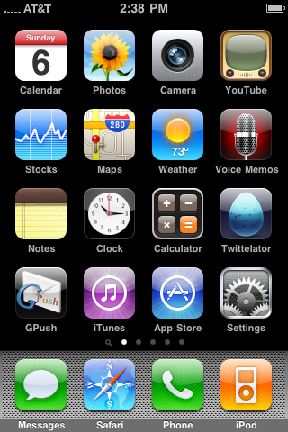

So I just got a replacement phone from apple 2 days ago because my WiFi stopped working. Now I have a different problem. In my house I usually get full bars on 3G but now with my new phone my signal just shuts down randomly and then connects back with full bars a few moments later. I don't know how to explain it well but I'll attach some screen shots to explain for me. Just notice the time and the signal strength.

Just got back from apple and they gave me a replacement phone. Apparently I had a faulty cell network reception chip. Might as well schedule yourself a appointment. Good luck.
