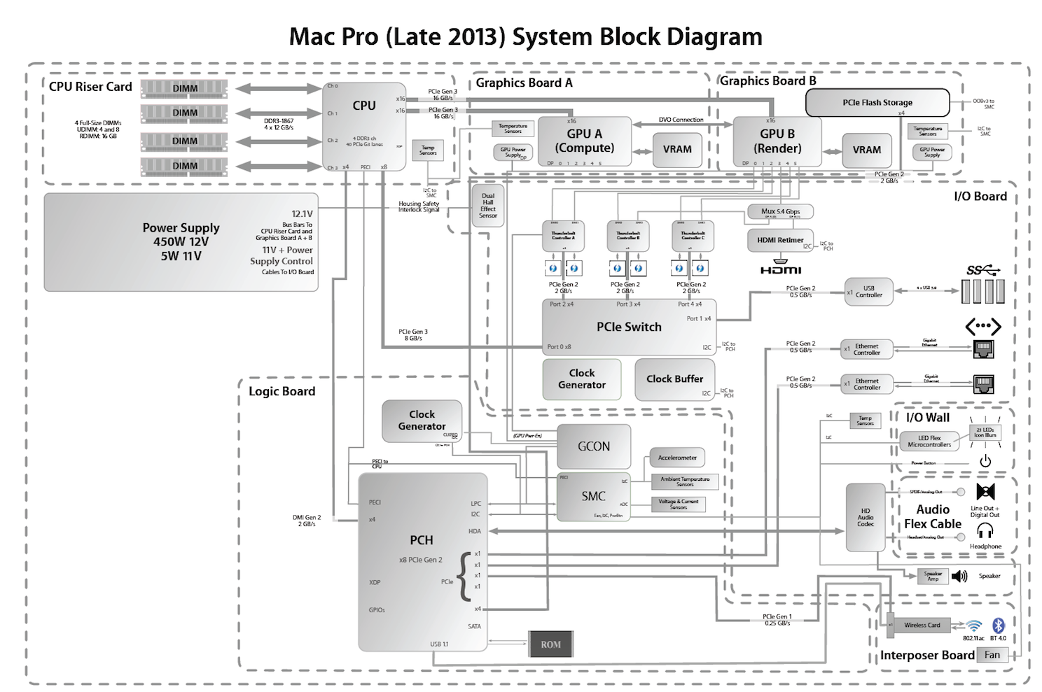

Only GPU B can display. As you can see from the block diagram, there is no link between the ports and GPU A. So, GPU A isn't there for more ports, but for more power to compute only.
Each card has their own VRAM, cannot be shared use. If the compute software can combine the VRAM pool by itself, then yes, you may get 12GB VRAM in total (for D700 only). But for 3D / display, only GPU B's VRAM can do the job.

View attachment 2368475Only GPU B can display. As you can see from the block diagram, there is no link between the ports and GPU A. So, GPU A isn't there for more ports, but for more power to compute only.
