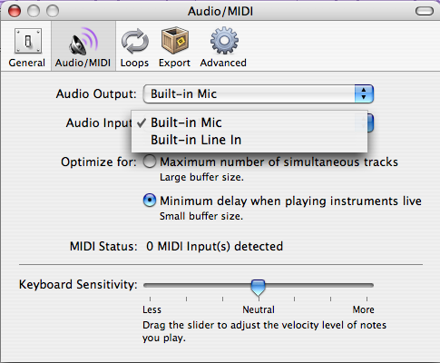

Did you set "Line in" in garageband preferences? That works fine with my electric guitar (haven't tried a microphone).
The only option available in my dropdown list is "Built-In Mic"...

epepper9 said:
Something's definitely wrong then.. 😕
Well, Line-In is an option in both Audio MIDI setup and System Preferences.. I'm not sure what's up with GarageBand...
