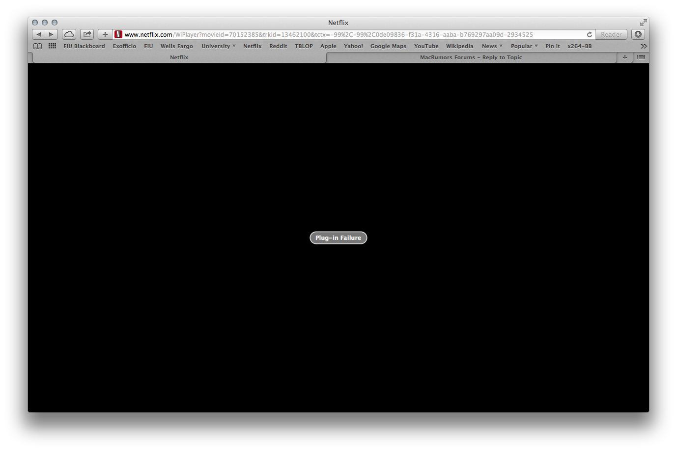

I went to update my silverlight for netflix the other day (March 11, the day Microsoft released a new version) and after install, all I get is "Plug-in failure" and a black screen. Running OS X 10.9.2, Safari 7.0.2 and Silverlight 5.1.30214.0.
Tried multiple deletions of the silverlight plugin and re-install, no avail. I heard disabling graphics switching is the trick, but that hasn't helped either. Works fine in Chrome (which isn't dependent on external plugins for silverlight I believe).
Any ideas?

Having the same exact issue. Silverlight won't work, gives a black screen but nothing else. Did all the standard rigamarole found online. Changed run settings to run at risk, prayed to Gaben, etc.

Same issue here - plugin failure appeared after the update. I'm unable to install Silverlight 5.1.2 as the installer detects a newer version despite the fact that i've trashed the plugin and all receipts. Any ideas on how I can revert back to 5.1.2?
UPDATE: I followed the instructions here https://support.mozilla.org/en-US/questions/924679 and this allowed me to fully remove silverlight and re-install 5.1.2. Netflix is now working again.
5.1.2 is available at http://microsoft-silverlight-mac.en.softonic.com/mac/download

Try using gfxcardstatus and force the integrated graphics. It should trigger a switch to discrete regardless. But this has worked for those with 2010 MBPs showing this issue.
Thanks all for the replies. Having the same issue across all browsers. I tried the EasyFind option to get rid of Silverlight and got the older version from the link above. But when I install it says a newer version is already installed. Any other tips on how to fully remove Silverlight? I've searched several times in EasyFind for silverlight and wpfe and everything is gone. Thanks!

I uninstalled and reinstalled silverlight a dozen times trying to fix this... then I went into my safari security settings (in the preferences window) and clicked the box "allow plug ins" and now it's working.
