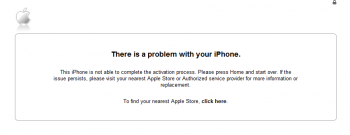

I just reset iOS in the settings app to try and re-activate it and I got this in iTunes:

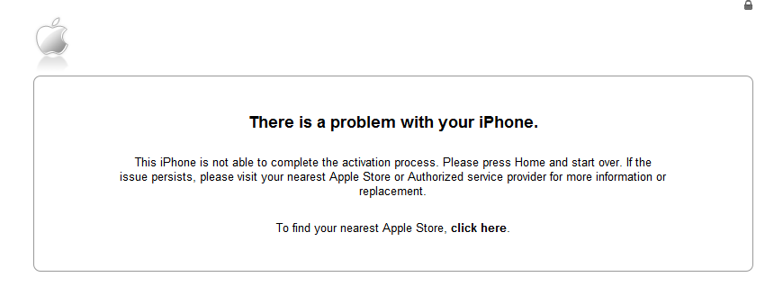

[doublepost=1479441994][/doublepost]Update
The phone just did this:

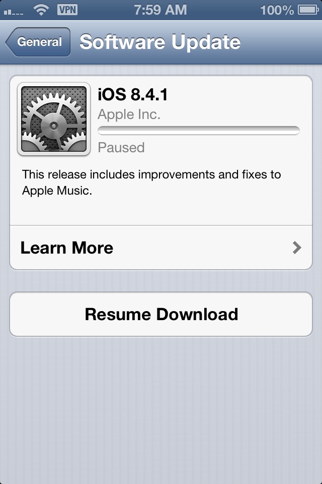

Nope. iTunes will only install iOS 9.3.5, but Apple signs OTA blobs for iOS 6.1.3, 8.4.1, and 9.3.5. Which means that you can stitch the OTA blobs and install them that way. If you have a 4S on iOS 5, without a computer, you must update to iOS 6.1.3, then you can update to 8.4.1, then you can go to 9.3.5.
This is what OTA software update does, it doesn't go to 9:
