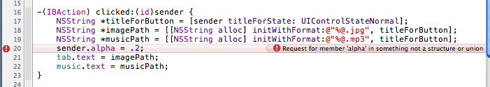

I have a whole bunch of buttons with the following action attached. I would like to include, in this action, an opacity change of the button. I thought maybe self.alpha or sender.alpha but it won't work. I'm just learning and would love some help.
Code:
-(IBAction) clicked:(id)sender {
	NSString *titleForButton = [sender titleForState: UIControlStateNormal];
	NSString *imagePath = [[NSString alloc] initWithFormat:@"%@.jpg", titleForButton];
	NSString *musicPath = [[NSString alloc] initWithFormat:@"%@.mp3", titleForButton];
	[COLOR="Red"]?.alpha = .2;[/COLOR]
	tab.text = imagePath;
	music.text = musicPath;
What didn't work with sender.alpha? sender should a pointer to the object that sent the message. Did you get a compiler warning? Or did it not work at runtime?
I get attached failed message.

It's basic C. You did learn C before Objective-C right? id is a shorthand for void *. Clearly that is untyped (effectively) so the compiler gives warnings about unrecognised messages.

[sender setAlpha:0.2]; worked fine as well.
