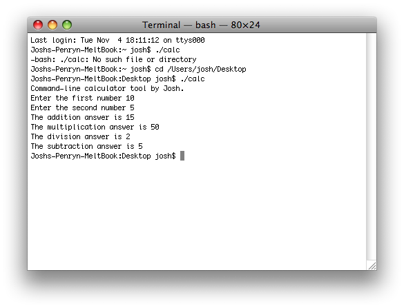

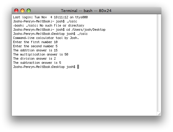

The new approach worked... I will try doing it again when I know a bit more.
This is the first program I wrote without using a tutorial, yay! 🙂
