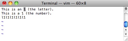

The default Terminal font in OS X is Menlo. It suits me fine, day-to-day.
The attached image is a screenshot of a vim session with some l's and 1's. They are pretty easy to tell apart in this font. XCode uses Monaco by default, and it's pretty easy to tell there, too. If you're using an earlier version it may be different, though.
-Lee
